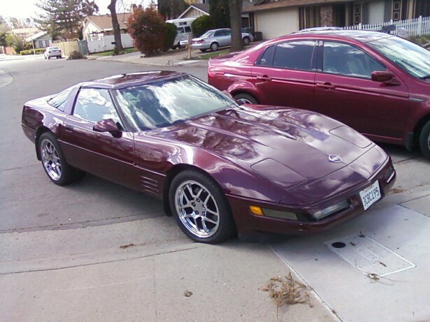

So about 4 weeks ago I bought my 93 ruby from a guy who tells me that has some problems where it wont start back up rught away after you shut it off. He says he thought the map sensor was the problem. I replaced it to no avail.At this point every warning light was always on and was leaking pint of oil daily. Well first I filled the brake fluid and got three of the lights to go off. Next I jacked up the car to check out the oil leak to find it running off the oil filter that was about to fall off. I tightened it and the leak stopped . Then on to the service engine light. I got someone to bring a code reader twenty something codes so we cleared them then got her started ran her and got 12 more codes. Well going over the wires I noticed the coolant temp sensor was melted off. I replaced the sensor and the check engine light hasn't been on since. Let me say I read alot of posts of 93's with same syptoms. Starts runs fine but service asr light comes on then joined by intermittent sys and security lights flashing.Once this occurs shut her of and forget about it restarting anytime soon. Sent computer in to be redone. Now she starts every time.. site.. THANKS TO EVERYONE HERE:happyanim::happyanim::happyanim::beer Btw way I found my 93 ruby on craigslist got it for $2300 she has a salvage title and some issues but I think I did OK. What do you think?
I tested computer by putting in freezer it worked when cold. so sent in for rebuild with computer repaired no mort start issues or wierd codes..

Well she didnt look quite so good when I got her. I spent alot of hours with compound and buffer just to get most the oxidation off. She looked liked she was left out in the desert sun for years with no sun screen.haha The pic hides the scars that are left..
All new cars are two stage paint, so what you buffed off is probably the clear coat, leaving what is typically a very thin color coat. You may have a tough time keeping the remaining paint looking good.
