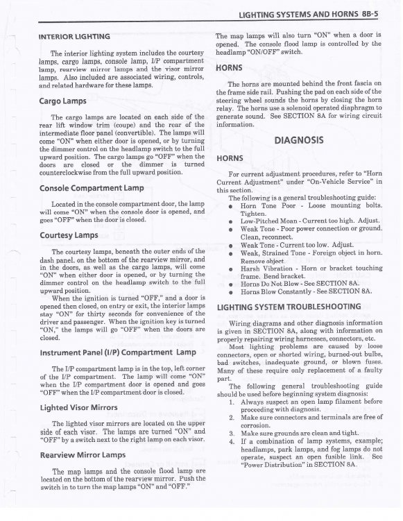

A Factory Service Manual would tell you where the wiring for those lights go. There is a timer hooked up to them. Might be involved in this issue.
Hope this will help with the Cargo Lights staying on.
Looking at wireing diagrams for the cargo lights in my 93 FSM there are just to many pages to be scanned . Look for all the switches that turn on the lights. There should be a switch on the hatch and on each of the doors. After making sure the headlight switch is not in the on position for the cargo lights. Open a door and press the switch in to see if the lights go out. If they do but stay on with door closed see if the plunger can be moved further out.

Check that the light switch in the dash is not turned all the way right to the click stop.. ( that locks the interior lights on ) .
2nd door pillar switches...
If neither of those work time to whip out the shop manual and trace the circuit.

A note to the OP. You have two more threads started for the problem with the cargo lights. The problem with doing that is those who are trying to help you here are not seeing all the information that is pertinent to helping to solve your issue. In one of the other threads you say you disconnected the hatch switch. I am not an electrical engineer but if you did not have a problem with the cargo lights staying on before you did that. Then it may be that by disconnecting the switch you created a circuit open signal to the ccm and it is simply doing what it is supposed to do which is to turn the light on when the hatch opens. You might try pushing the plunger for that switch in to see if that turns the lights out. If that switch is bad you could then put a normally open switch from radio shack in its place and the system would then think the hatch is always closed.
