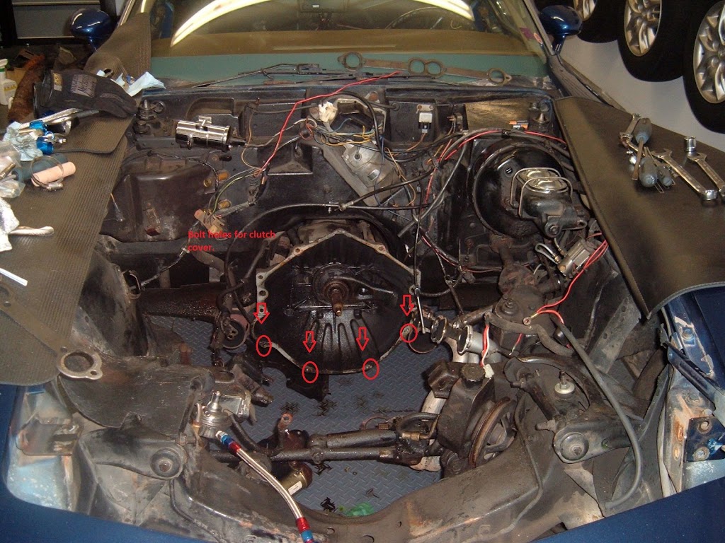

I have realized that I have no clutch bellhousing front cover.
Does this mount from the "outside" or do I need to unbolt the bellhousing to mount it?
/Johan
It goes on the outside surface of the clutch housing.
Look carefully on the lower have of the housing rims and you should see the bolt holes.
It's only 4 small bolt at the bottom part of the bell housing. Very easy to install. You might need to remove starter to get to that last bolt on passenger side.
Here's a picture, You'll find the bolt heads on the transmission side screwing towards the front of the engine.
Ok thanks. I just recently bolted the tranny to the engine and put it on the frame, and then it struck me that the cover maybe should have been mounted before that, but then I'm ok.
