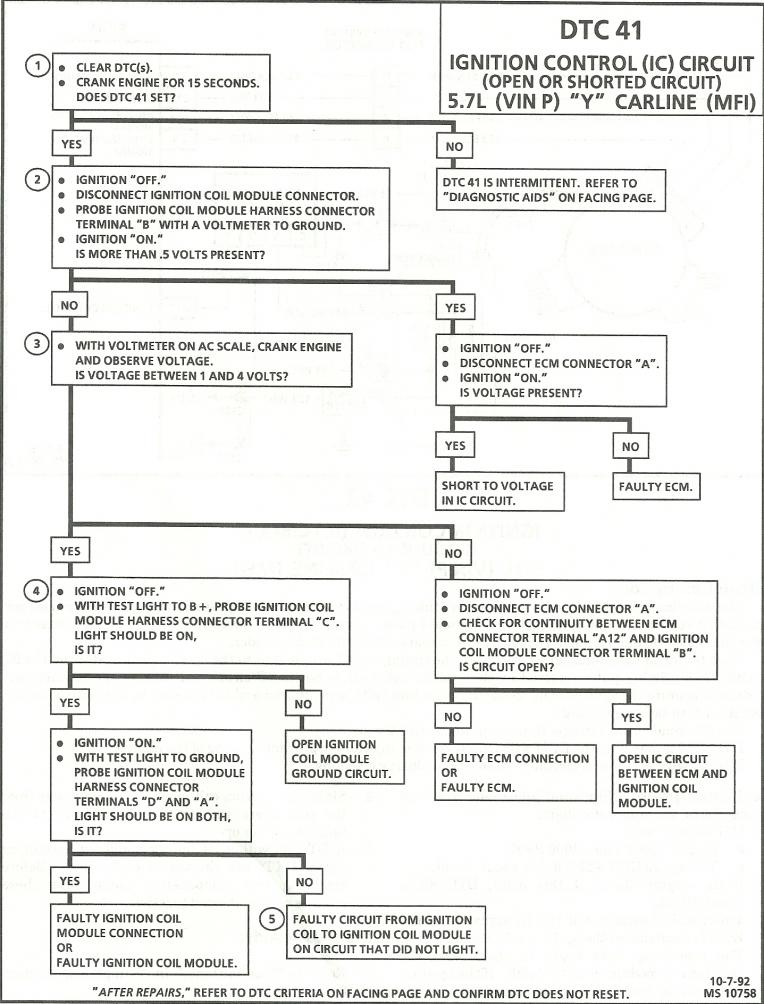

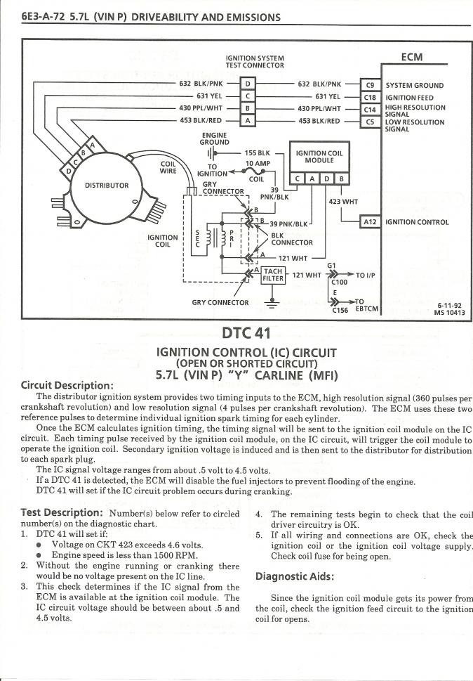

Hope this helps you with the C41 Code
http://i285.photobucket.com/albums/ll72/John-68/DTC410002.jpg
http://i285.photobucket.com/albums/ll72/John-68/DTC410001.jpg

DTC 41 gives same symptoms as VATS shutdown.
Not that simple, many have invested lots of time and $$$ have still not resolved the problem.
Is a well documented problem with this in 92 / 93 cars ; many unresolved by ECM repair/ replacement
