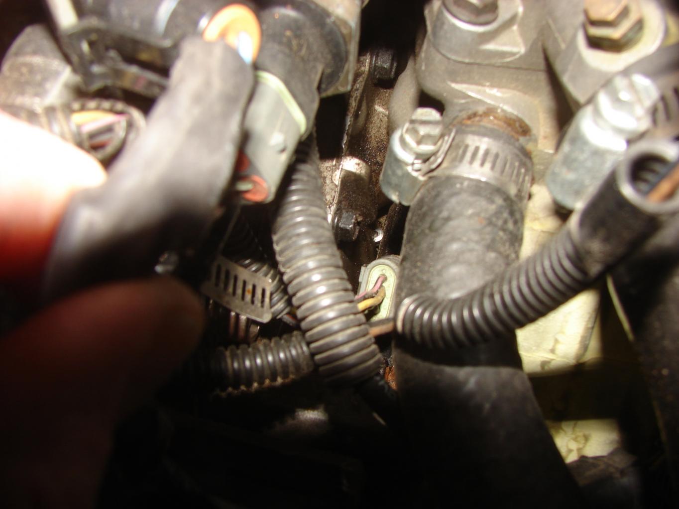

I have checked all the wires, ALL of them, of ALL the car! i found 3 broken wires and i replace it.
