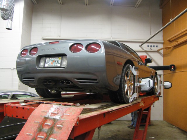

The good news is my transmission is back together and works flawlessly!:thumb
Put the car up on the rack and aligned it this morning and it runs and drives like new!:thumb:thumb
The bad news is ,Some A$$hole hit it in the parking lot and did $1700.00 in damage and left the scene!:hb:hb:hb

It doesn't rain but it pours!!
-Mac
-Mac
Yeah Mac,It seems so.
I could have done this work at home,But I was ask to do it at the school and I wanted to help young technicians learn.
Between this,dead beat customers and incompetent parts people,It's just almost to the point that I don't give a Rats Pa-toot if everybody has to ride a bicycle!~!!:eyerole:eyerole:eyerole
What a pain in the butt!
