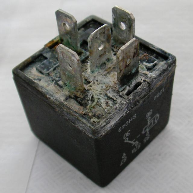

Here's the culprit. It was buried deep in the back well behind the passenger seat. Had to yank out all the wiring and the radio receiver box to get at it. I had a bunch of junkyard spares and luckily had one that was a perfect match.

And if you thought the outside looked bad, wait until you see the guts on the inside...
This is the joy of convertibles and leaky seals... It's a damn good thing these cars use so many composite materials. I replaced the bow seal in '05 and the entire soft top in '08, but the damage had already been done. Honestly I don't know why it still worked at all up until a few months ago.
I found it's common for that passenger well to fill with water, even on a coupe. It comes in around the rear seal and runs down behind the carpet into the well. When my radio reciever went bad, I took over a quart of water out of the well! I looks like your solenoids were submerged.
After the Seattle rainy-season of '06 I discovered about that much water in the well too, and it was clear something had to be done about it. I tried silicone in various places but nothing seemed to stop it. It wasn't until I got the hardtop in '07 that my water problems were solved with this car. The receiver box survived (barely), but it killed the first relay. I didn't even know about that second one until yesterday.
