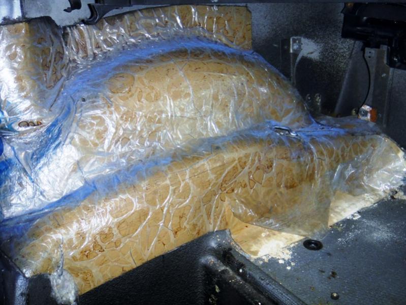

Hi Guys , the saga continues ...thanks for the replies on how to get the seat cushions into the shells , wasnt easy ...hell of a workout . well any ways . ONE of my rear wheel well humps (gettting ready to install carpet),has this ceramicie /clay like paper/plastic shell over it , the other is bare , what is this ?Is it supposed to be on both humps ?? Do I need it ??

What should I replace it with ? It's kind of hard like a clay , should I remove it and cover both humps with insulation / dynamat or a fiber pad . I havent fitted the rear carpet section yet ,but if it is supposed to be there then i'm going to guess that the carpet manufacturers take it into consideration ,and i'm going to need to fill up the space ..

Tire Hump
Took a quick picture of the well ...no damage under it and it looks kinda factory ...any ideas??
I don't know what that would be...
I know what I would do ;)
I would leave the "kind of hard like a clay" stuff there and when you have your carpet ready I would lay it in over the entire back end and see how it fit. Then try it with the new insulation, if it looked good, then :thumb
If it don't I'd cross that bridge if it seemed not right ;)
Bud
I think the clay like stuff is the original sound deadener. My 82 had the same on the passenger side. The driver side had a thick black tar paper like covering that I would also guess was original. No idea why they would be different but I left them that way.
My replacement carpet fit pretty loose over the the wheel wells. I added padding on top of the sound deadener in select areas to get the carpet to lay in a smooth arc over the wheel. For padding I bought Mid America's box of sound deadener. This is an inexpensive box stuffed full of various sized pieces of foil-backed padding.
I put a dynamat like thin rubber pad on the floor of the cargo area and up the back wall. I then topped the floor off with another piece of foil-back padding from the box. I also used the rubber and foil-back combo on the floor pans and trans tunnel. This makes a big difference in cabin noise and heat.
Whew , at least I'm not alone , so it probably was factory , guess I will seal it up and work around it with new insulation ..

Purchase the assembly instruction manual (AIM). The AIM has five or six pages dealing with the installation of the factory sound deadener. In a nutshell, it was sprayed pretty much everywhere, inside and out.
The AIM also shows installation of the carpets.
