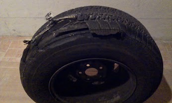

Unfortunately last Saturday whil coming home from an american car meeting, while I was on the highway, I started to feel a small vibration from the rear; at first I thought about having lost a wheel balancing lead; then the vibration incresed, so I slowed down, and after few km the rear left tire tread broke away.
Fortunately the jack was OK the spare tire - I suppose a 37 years old GR70 "International tires"- was still good and after one hour of work and a stop to next gas station for pressure check drive slowly bute i got at homebroken tire.jpg
So the Vette now is waiting for four new Cooper Cobra from the USA; I will take the occasion for cleaning and repainting the wheel rims and checking with attention all the Chorome ring clips
