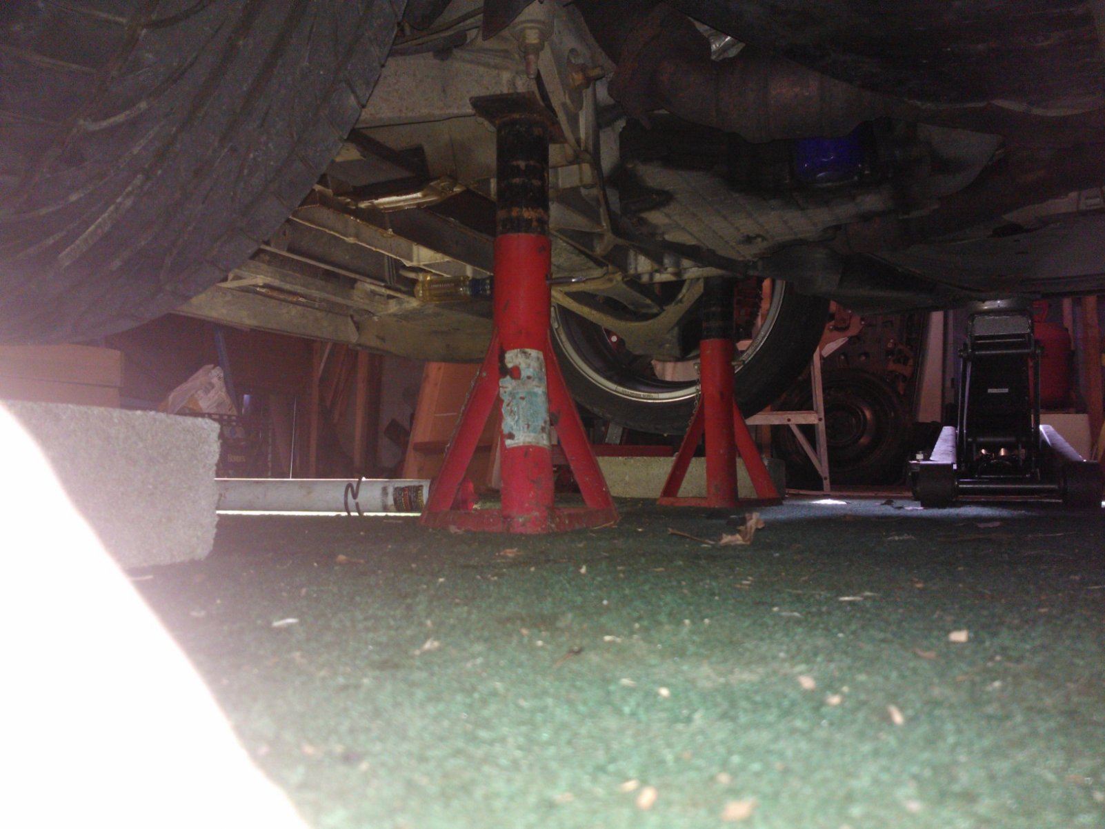

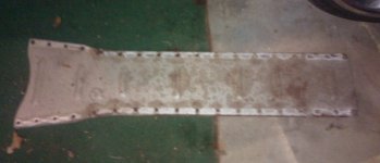

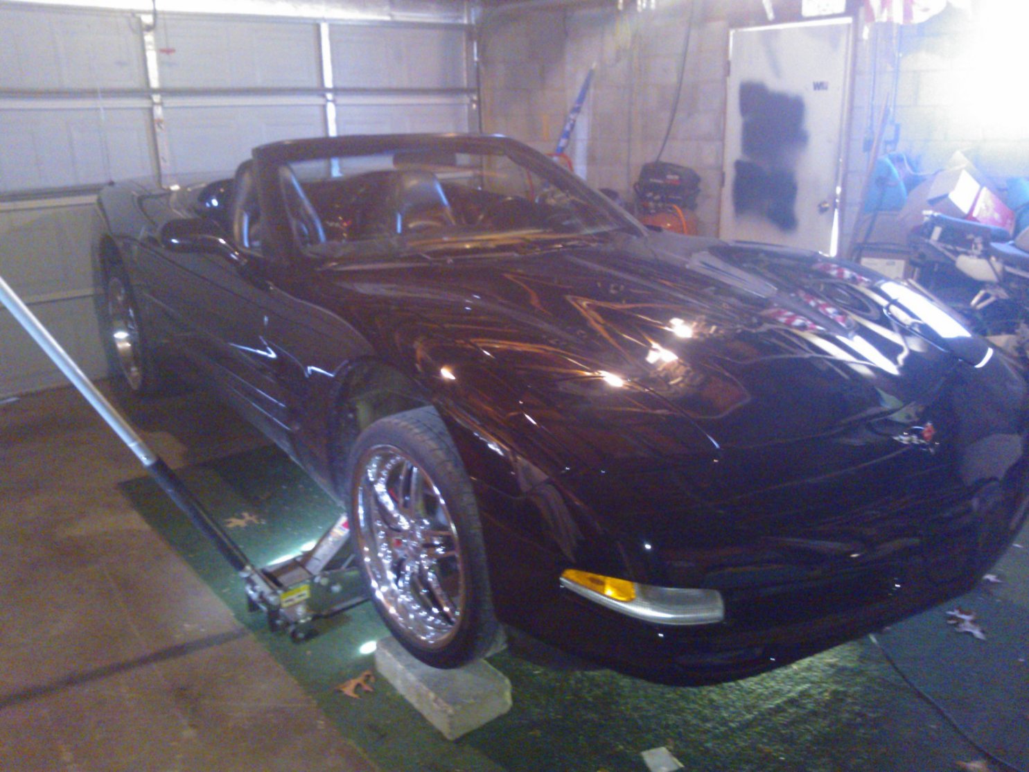

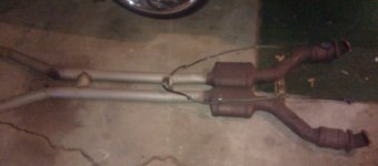

I had done this on other cars over the years (and bikes) so I tried it on the Vette and it worked! Car's up on jack stands.
Gravity bleeding by just opening the bleed screw on the slave cylinder and letting it drip into a pan worked great.
Moved the pedal up and down slowly by hand a few times at the beginning starts things flowing and made sure there were no obstructions.
Kept the reservoir topped off and just let it go. After about half of a LARGE bottle of fluid I closed the bleed screw.
Then I pumped the pedal by hand a few times. Got some bubbles come to the top.
All is well! Have a great pedal now.
BTW: Snapped off 4 of 6 manifold flange studs. Good thing I have a cutoff wheel. Chevy Parts wanted $14 EACH for new studs. Nuts extra. NAPA had generic ones next day, a package of 6 studs & 6 nuts for $14. Driver's side done. Lowe's has a combo pack with a metric tap 10mm x 1.5 and a drill bit.

I found this picture on the internet. This torque tube is oriented as you'll see it under the car. From underneath you can easily see the hard line as it enters the housing. The bleed screw is above the hard line and points at an angle toward the driver's side.
You CANNOT reach straight up from under the bleeder to reach it. Position yourself about where this red screwjack is and look forward.
Then you can see the bleeder and the angle you need to place the box wrench. I had out both an 11mm and a 7/16 wrench. I think I used the 7/16.
