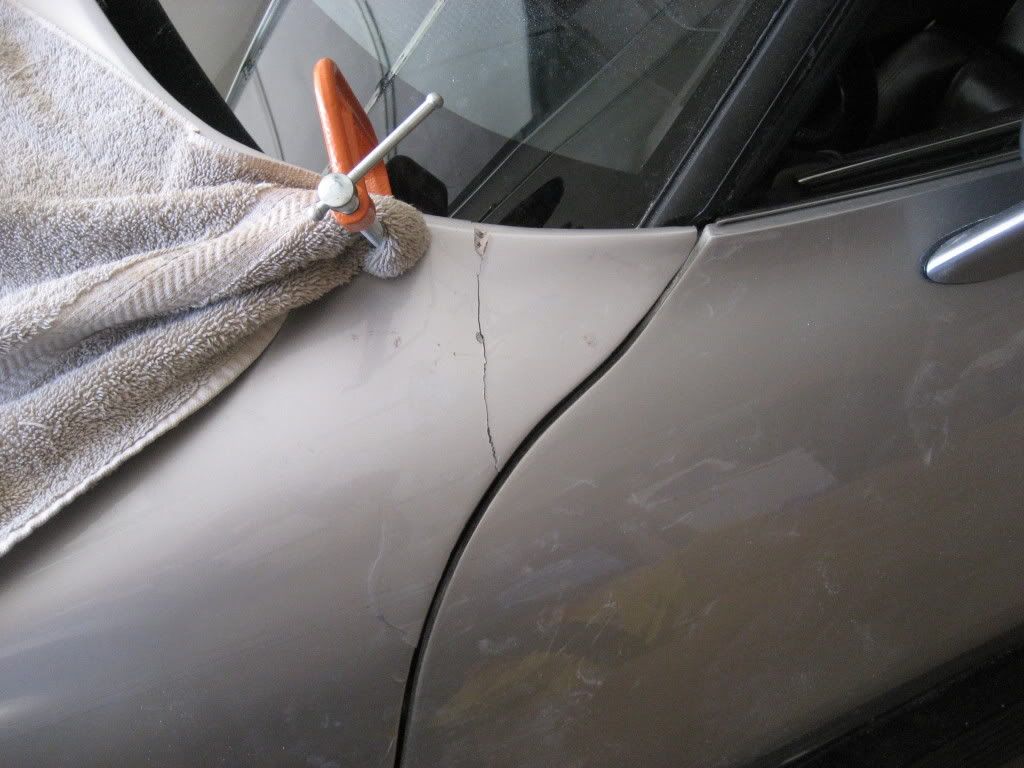

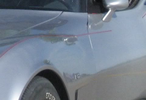

Fender: Before
This isn't the best picture- but it does highlight the terrible fit between the fender and the rest of the car. This picture is from the previous spring.
Poor previous repairs

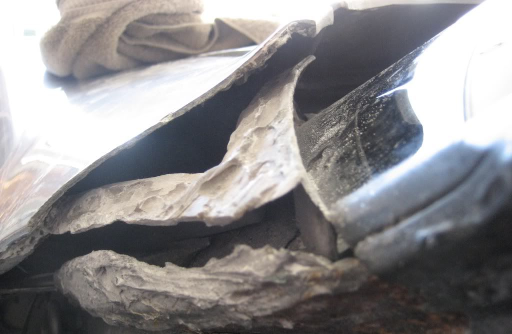

When I pulled the fender loose from the bonding strips, I was amazed at how much panel adhesive was sitting between the cowl strips and the top of the fender. There must have been a 1/25 inch of adhesive. The fender would NEVER have sat right with that much space filled in with adhesive. It looked like someone had no clue how to repair fiberglass... or worse, they just didn't care.
Worse yet, a previous repair was made with only resin to reattach the upper portion of the fender back to the cowl. It came loose and snapped off. Not a problem- I'd just put it back together like it was supposed to have been done the first time.

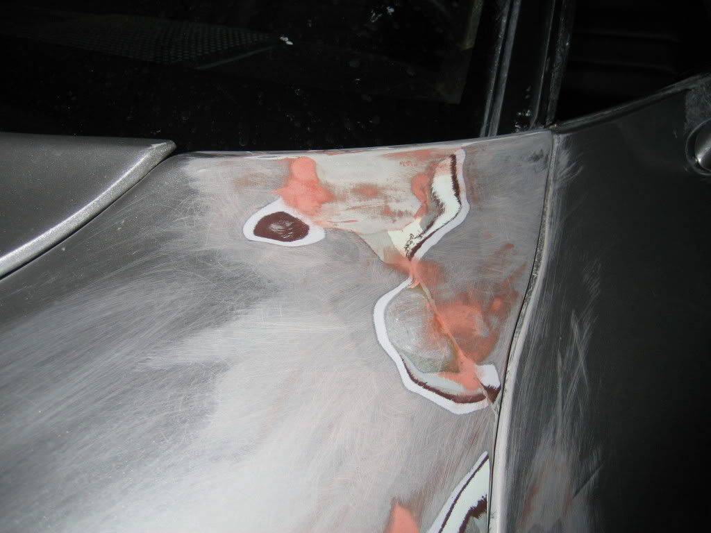

Getting there- one day at a time
Bonded, repaired, scratch filled, sanded, and ready for 400 grit! Getting the curve just right along the repair was a challenge. I must have sanded and tweaked the amount of Evercoat a handful of times before I was happy with the results.

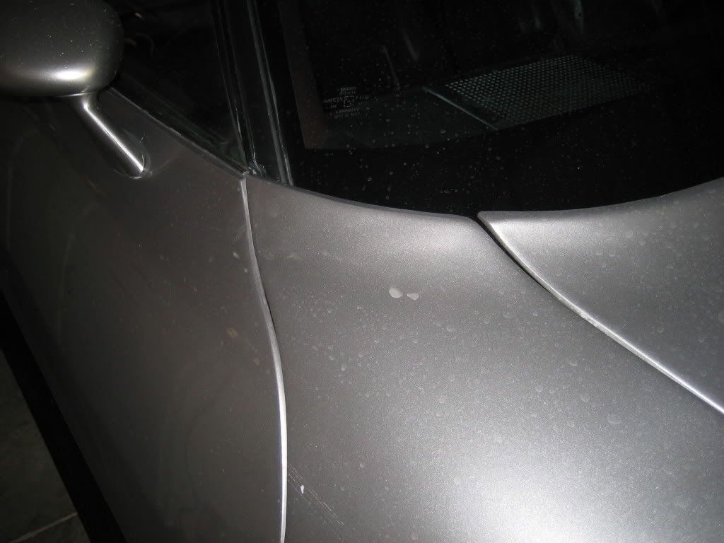

The other side for comparison...
The height of the hood will need to be adjusted, but overall it looks a lot better!

Fender: Before
