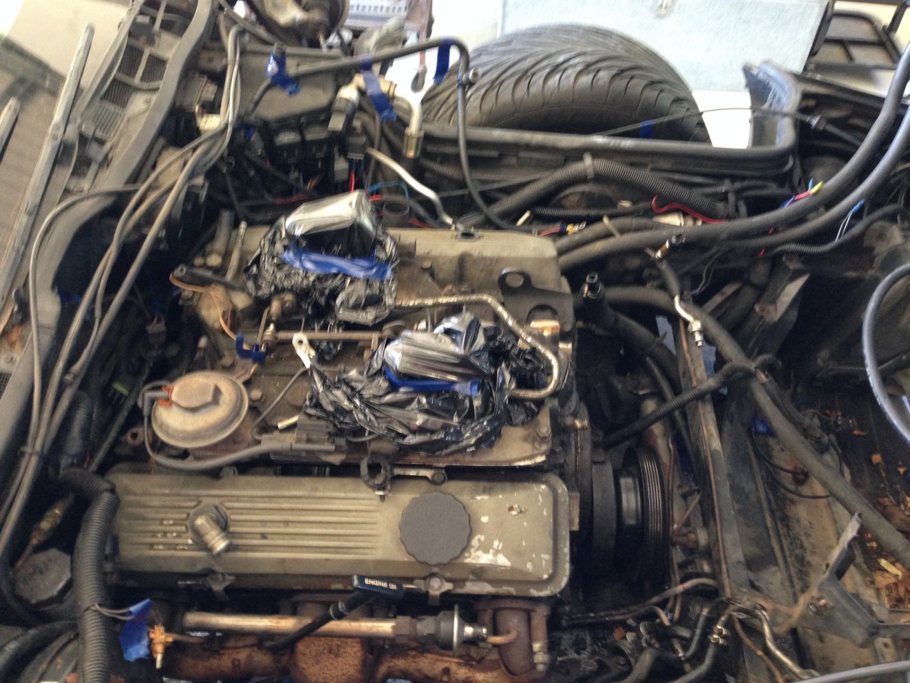

Slowly removing engine and trans
Hi Guys,
Slowly removing the driveline, driveshaft and gearbox is now out.
Front pulleys, engine covers, dizzy and radiator are all out.
Providing the crank and block are ok, I am looking at:
Edelbrock 60975 heads - suit retro roller cam upgrade Etec 170
Edelbrock retro roller cam kit 22015 - includes roller cam, lifters, push rods
Edelbrock timing chain 7800
Edlebrock intake 7516
I am also looking at the Estreet E3600 bolt on EFI system.
just have to check hood clearance to see if we are modifying it.
Edelbrock rate this combo with an 800 cfm carb at 435HP on a standard 4 bolt block, compression 9.5:1
Have spoken to supplier about the EFI system, I should be able to use my original fuel lines, but upgrade the fuel pump, which I had to do anyway.
Planning on slotting the Tremec TKO 600 behind this using one of SST's kits.
Now, back to job hunting, as it is free to disassemble, but costs big bucks to rebuild.
Cheers
Tony
