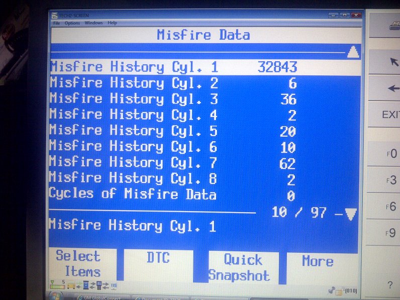

Hi there,
Ok, first, lets start with the basics. I see 3 things that make me wonder.
#1, Was a fuel sample taken ????? You had 2 gallons left, which tells me that there is not a low fuel LEVEL problem, but maybe a fuel QUANTITY or QUALITY problem. Ethanol more than 10% can yield drivability issues but certainly not backfiring through the intake. Also, be aware that ethanol encapsulates moisture so adding more drygas can create hesitation and lower power from your engine. The ethanol in the fuel would be enough to take the moisture out of the tank and burn it accurately without issue, UNLESS you got more than a cup or 2 of water.
#2, you stated there was a misfire code. What was the code number? Even if it was a basic P0300 misfire, the misfire DATA within the engine control module will tell you WHICH cylinder was misfiring the most so you can focus on that cylinder. Certainly, I would be very interested in that data. You can reference the picture below to understand the data I speak of.
#3, if you had all those warning lights, THERE WILL BE other codes within the control modules of the Corvette. These codes, while some can overlook, SHOULD ALWAYS be documented and verified. They can give you hints as to where to proceed for diagnostics and point you in a solid direction. NOTE: a misfire can cause a 'service light' although, I would seriously dig deeper here.
A couple of notes from my point of view.
I would be looking at the fuel trim data as well as the information on the misfire data. There is no question that if there is a fuel issue, the fuel trim tables will either be adding or taking away fuel from your engine.
DO NOT DISCOUNT ANYTHING, as this low mileage dictates that nothing be overlooked.
Allthebest, Paul
If I understand the time line correctly, the car had 1900 miles on it a year ago when the OP purchased it. In that year he added 4000 miles, so it seems unlikely that old gas full of water would be possible.
