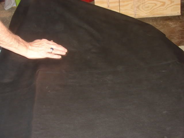

I first bought some black felt like material at Jo Ann Fabrics but was not happy with the idea of the glue soaking through it and staining it. Went back to Jo Ann and found some black Naugahyde on sale for $5.00 a yard. Used it and some spray adhesive to put it on the backer. I then used liquid nails to fasten the backer to the roof panel.
I think the pictures may help with Boomdrivers information on how to do this job.
My total cost was less than $25.00 for everything.
