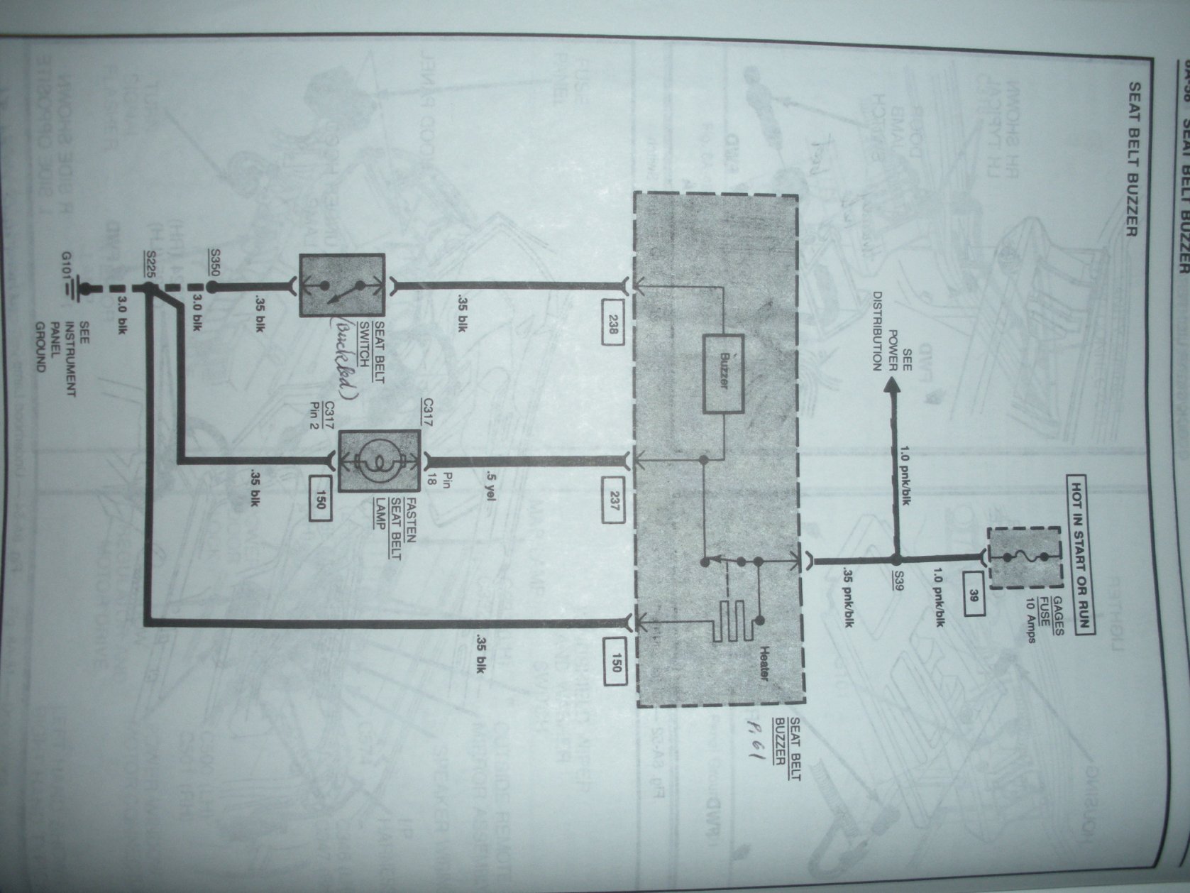

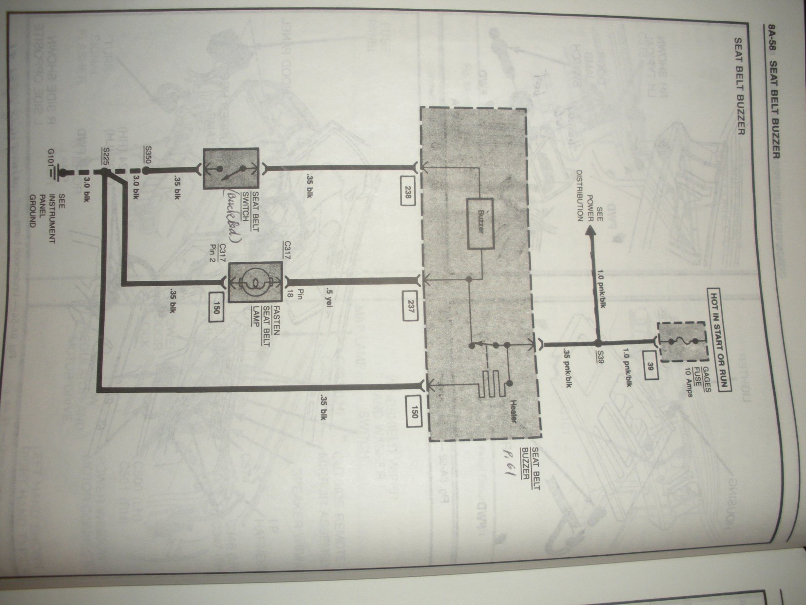

Here's the circuit for the seat belt lamp. Notice that there is no separate connector. The wires plug into the switch, which is inside the buckle.
Sorry this comes out so small. Click on the picture to enlarge it.
hcbph, since you have the '86 big book tech manual, is this diagram from my '84 FSM different than your '86? Is this diagram in your '86 manual?
