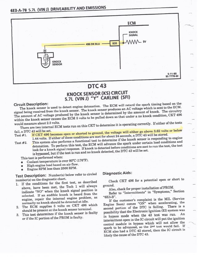

In most cases the sensors are good it's the wiring and grounds that have gone bad. Until you eliminated bad grounds and wires as the problem stop throwing parts at it. I am sending copies of the DTC code sheets from 93 FSM. Hope they help you to find the problem. Before you buy any more parts go to ebay and buy a 2 volume FSM set for your car.
Code 43,63,640001.jpgCode 43,63,640002.jpgCode 43,63,640003.jpgCode 43,63,640004.jpgCode 43,63,640005.jpgCode 43,63,640006.jpgCode 43,63,640007.jpg
View attachment 9813View attachment 9814View attachment 9815View attachment 9816View attachment 9817View attachment 9818View attachment 9819
Understood. Throwing parts at it ain't going to solve the problem. However at 18 years old it would hurt. I do see one plug on cylinder 8 that needs to be replaced. Looks like the central electrode burned down some and a tiny piece stuck to the ground side.
