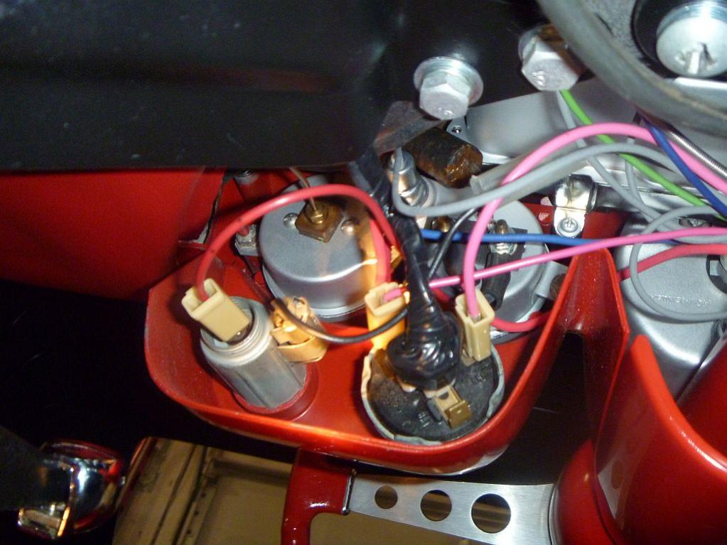

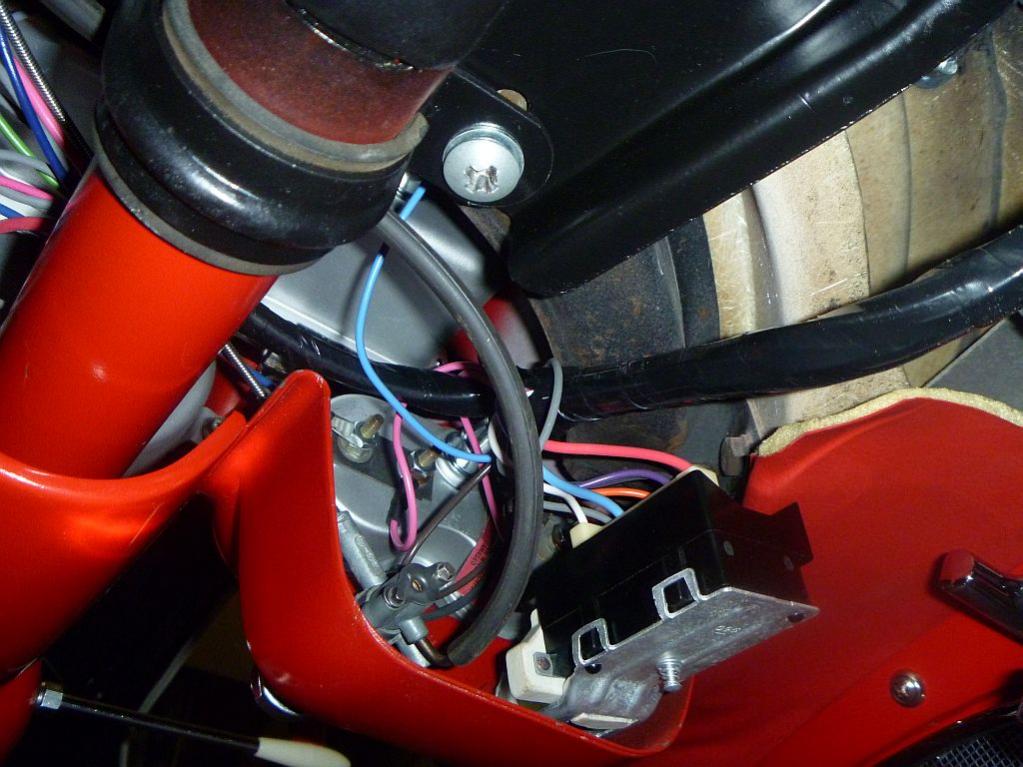

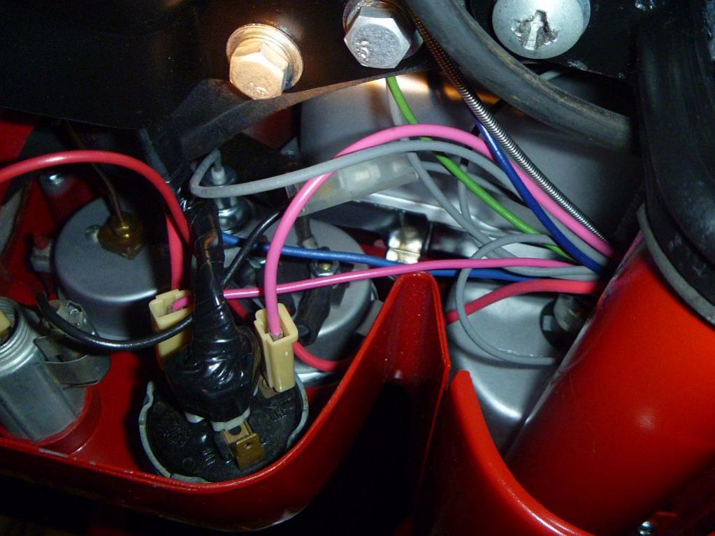

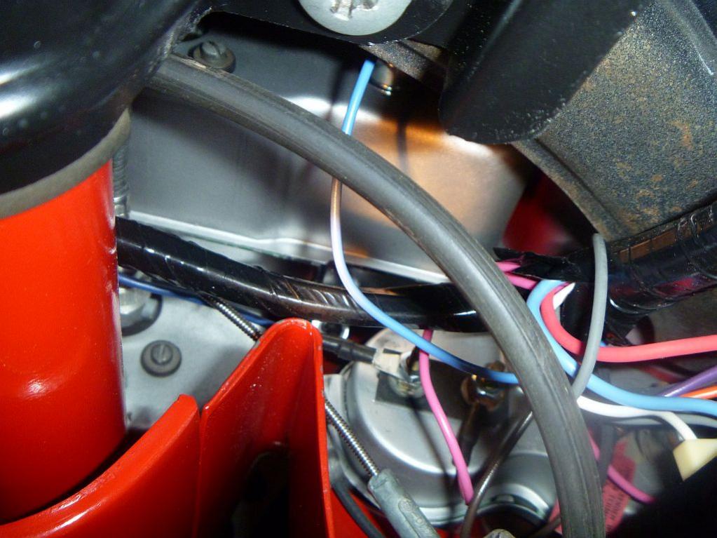

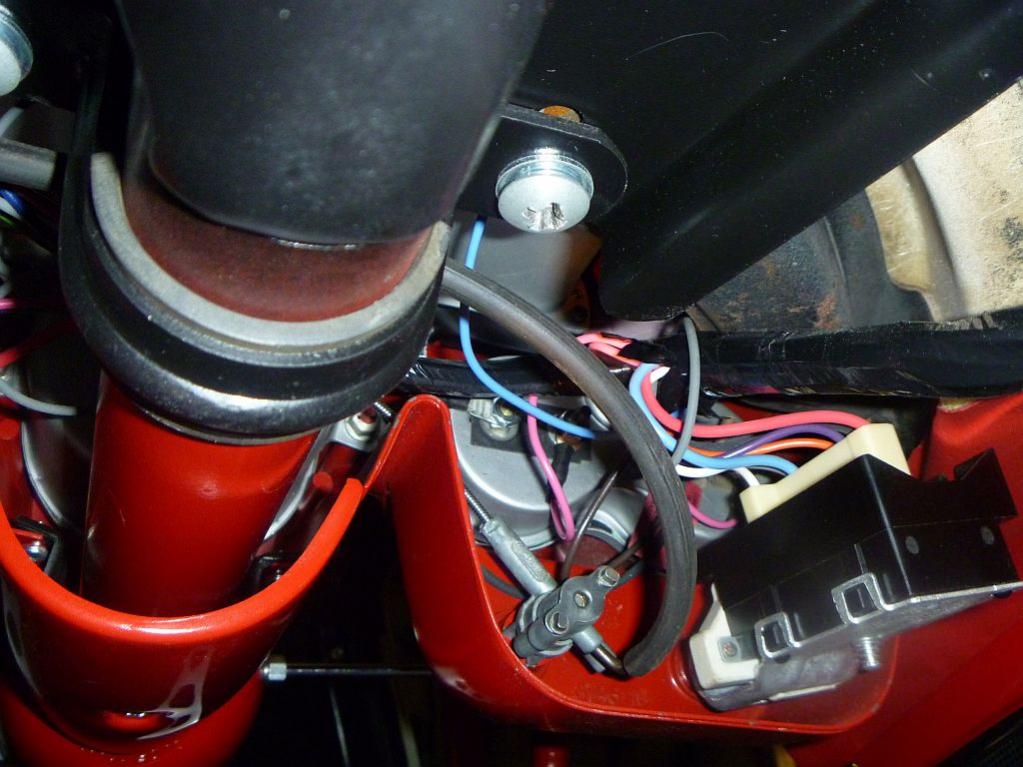

I have not pulled a speedometer in the 59. But, I have some photos of what the under side of my dash looks like.
You should definitely take photos of what your wires, etc. look like before your try to remove anything.
Good Luck. :w

thank you for the photos. they will definitely help, vinny
