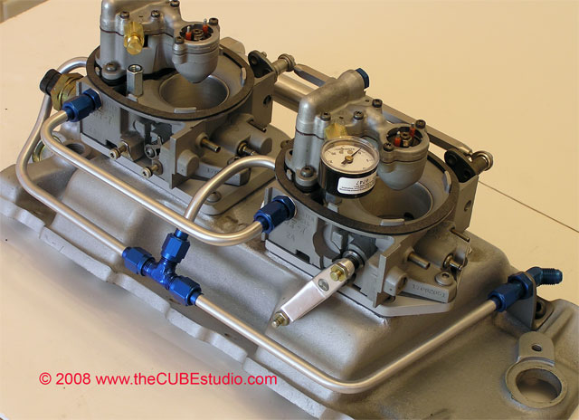

When it comes to CrossXXX manifolds, it's hard to beat the proven performance and ultimate 'cool factor' of an Offy CrossRAM. Follow the link to see the entire process from concept to finished product.
A lot of people don't know that Crossfire TBs are actually from a 4 cylinder engine . . the only TBs GM had available at the time. The bad part is that they have dismal flow out of the box . . and troublesome dual IACs. The tiny TBs are THE restriction on Crossfire, not the manifold. The good part is that with no adjacent throat, the little 4 banger TBs can be bored out and even sleeved to rediculous levels not obtainable even with a BB two barrel TB. The following link shows how to put together some interesting induction setups using highly modified Crossfire TB's. CROSSFIRE tech HOW-TO thread - Corvette Forum : DigitalCorvettes.com Corvette Forums
FinalAssemblyLeftRearWEB.jpg Crossfire TBs, because they can be properly balanced, will run smoothly and with crisp stumble free off-idle and tip-in behavior in a variety of configurations. Go crazy. That's what hot-rodding is all about.
No need to be restricted to the stock manifold (which is actually a very good street performance manifold with an aggressive port job), or unproven aftermarket replacments. At the end of the above linked thread is a step by step HOW-TO for porting a stock Crossfire manifold. Only the mods specific to the Crossfire are detailed. Port matching is the same for any manifold and has doubtless been covered a thousand times, so I did not add to that pile.
