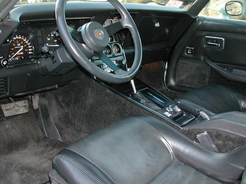

The interior basically needs new weatherproofing rubber, and I need to send the radio to that place that 81kix (I believe) suggested. The AM is not working. View attachment 11550 I am also still looking for a driver side T-top in good condition. Mine has small cracks on the glass, but it does not leak. If you remember my steering wheel in CF I, then you'll notice a better one in its place. This one is original and is in mint condition. Found it in eBay for about $50 buckaroos.:beer
