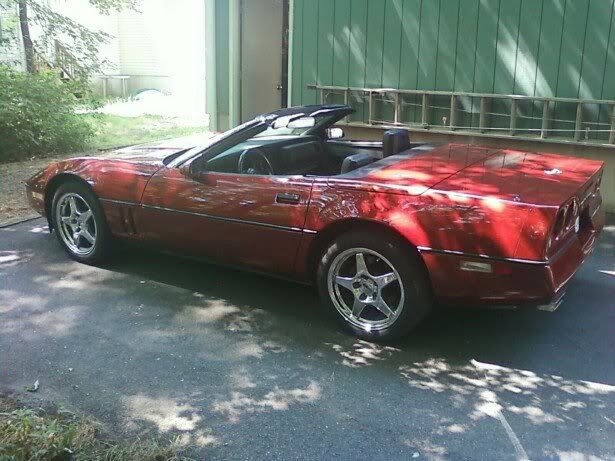

I just traded my 85 Porsche 911 for an 87 corvette vert. It had a few bugs which I worked out except for 2. First my speedo would fluctuate mainly reading zero. Sometimes it would get so bad the would go back and forth between zero to highway speeds sending the lock-up converter into a fit. I was sure a speed sensor would fix it. I repaced it and at first it was still all over the place then it smoothed out and started working. I did notice that when I hit a bump or took a turn it would fluctuate that clear up. I smacked the top of the dash a few time and it caused no disturbance. So I am thinking a bad connection or wiring between the cluster and the speed sensor.

So how do you like the Corvette vs. the 911?
CG
I bought the porsche off a customer of mine for $2000. It was a drivable car but needed work. Second gear needed a syncro and it needed valve guides. It was going to cost me $4k in machine shop fees and parts to fix the car. I did not enjoy driving the car. It is very quick, the corvette could never keep up.If I were younger I would have kept it.
The vette is just more comfortable to drive. Not as fast and dosen't handle as well. I have more fun with the vette.
