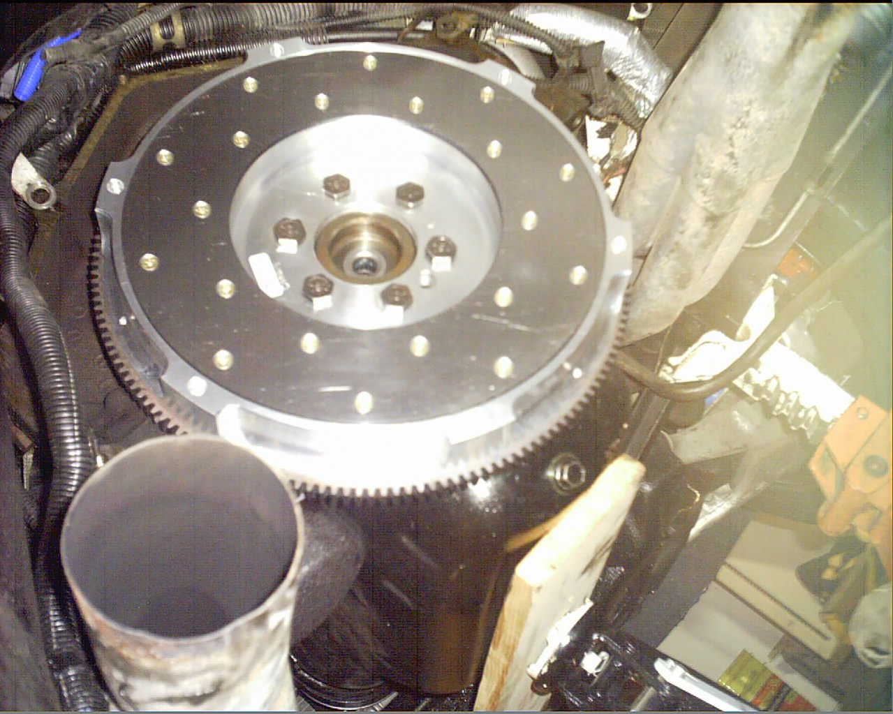

Tony,
When I did this, I had to modify the trans tunnel because of how the 4+3 shifter is mounted, which sucks IMO. So I grafted part of a 90 tunnel since the ZF-6 has an internal rail setup.
I also added a Fidanza Aluminum FW, ZF-6 Bell Housing and LT-1 clutch and pressure plate. Also the C beam is shorter since the ZF is a longer trans. I installed a short throw Hurst shifter prior to inserting the trans into the chassis. Make certain that the ZF is not from a ZR-1, which has a longer input shaft and uses a deeper bellhousing. Its a bit of work, but it made the car soooooo much more fun to drive. The ZF weighs more but it also seemed to produce a lower center of gravity and one which distributed the vehicle weight more evenly between the axles.
Transtunnel001.jpgFidanza installed001.jpgTranstunnel002.jpgTranstunnel003.jpg
