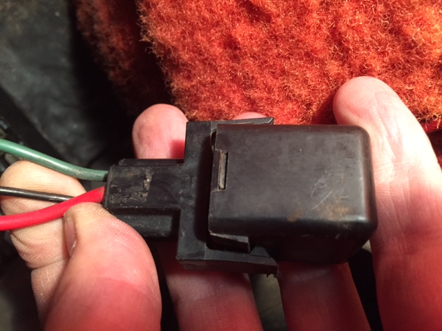

I recently purchased a 77 Corvette and the rear brake lights were not working. I found the brake switch at the pedal to be defective so I replaced it and now the left side works fine. I replaced all 4 connectors on the rear and installed new bulbs and still the right brake light and hazard does not work. I checked the connector that is under the dash and found the yellow wire, feeding the left side to have voltage and I found the green wire, feeding the right side to not have any voltage. Where do I go from here? I can see when the hazards are on only the left side indicator in the dash flashes. Any ideas? I also found a 3 prong black unit that I thought at first was the flasher unit, but I then found the hazard flasher mounted on the fuse panel. What is this unit? See attached picture. Any idea? Thanks for any help you can provide.
This is your horn relay.

Thanks for the comment on the horn relay. Horn does work, so I know it's a good part.
