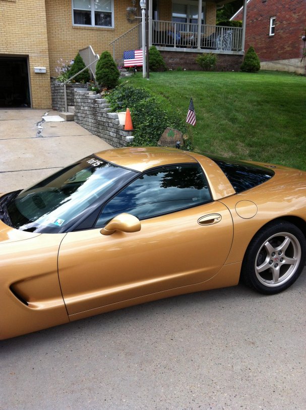

I do not mean to change the subject, but I noticed you,"puppyfang",have a 89 Charcoal coupe. Do you have any photos of it.I have an 89 coupe,same color,and have never seen another 89 charcoal any where. They only made 1,440 of that color that year and I'm surprised to see someone else has one. I would very much like to see yours if at all possible.
yes, do have a 1989 that is the charcoal metallic...here is a picture before mods ...Know that there was only 1440 made...took mine to chevy shop to have something checked and they thought it was a repaint until they looked it up...love the color, having some engine mods done right now as it needed more horsepower...and put on a set of black grand sport rims...what an improvement...starting to make it my personal GS...for 1989....thanks
