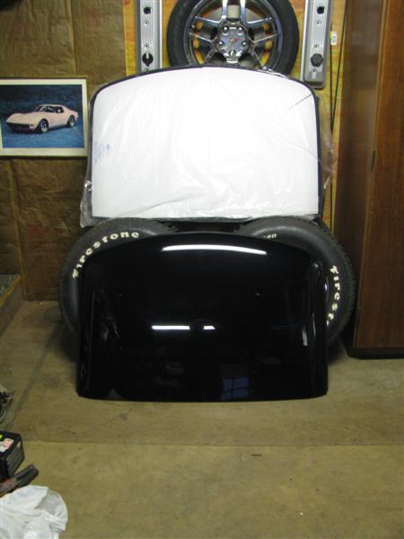

I've had them crack or de-laminate before just pulling them out of a heated garage on a extremely cold winter day!~!!;shrug
Good news is,I have 2 Genuine GM Blue Tints in stock for 1990-1996!~!!:D
1 Slightly Used,Excellent Condition less than 2 years old,been in my office 95+% of the time!~!!
1 NEW,Still in Factory Protective Film! :thumb
Will SHIP!~!!
If picked up here,I'll personally adjust for proper fit to vehicle!:upthumbs
