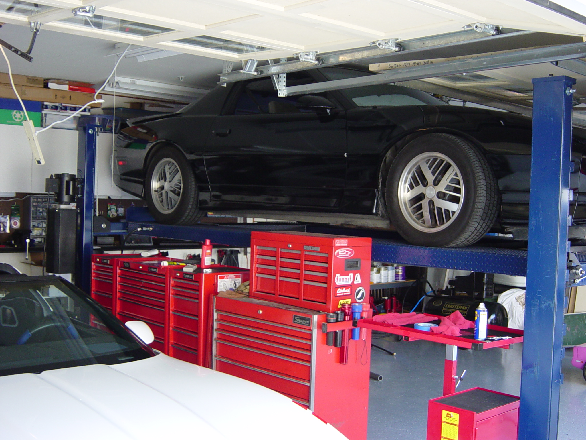

I got a 4 post. Wasn't sure of the strength of the concrete so was a little leary of bolting a 2 post down. I also added the 2 struts at each post for my own piece of mind. You may be able to make out the large mirror on the wall in front. It's placed and angled so I can clearly see the tires from the driver's seat as I pull onto it.
