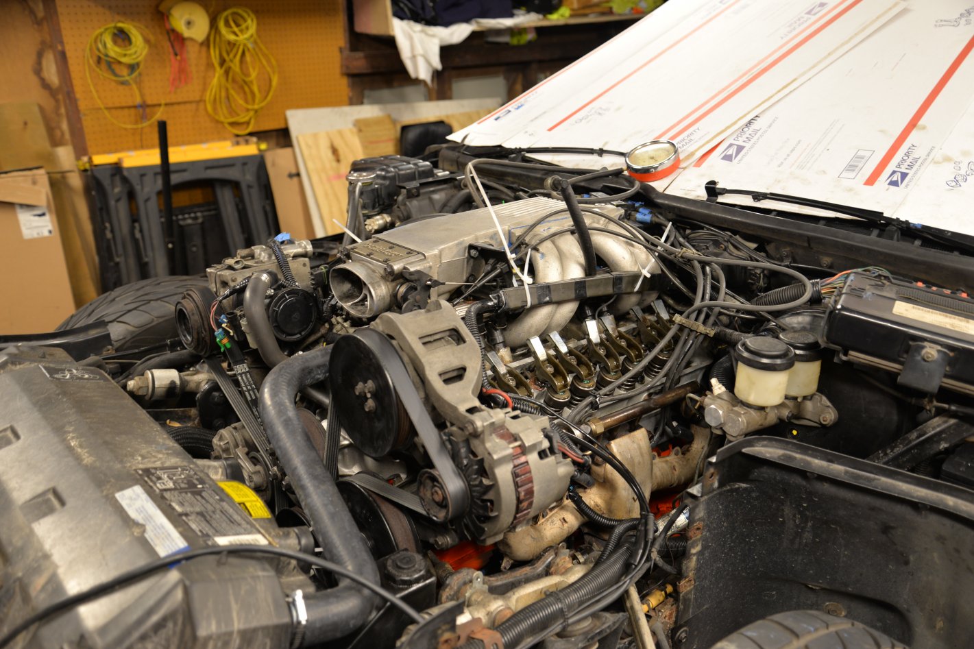

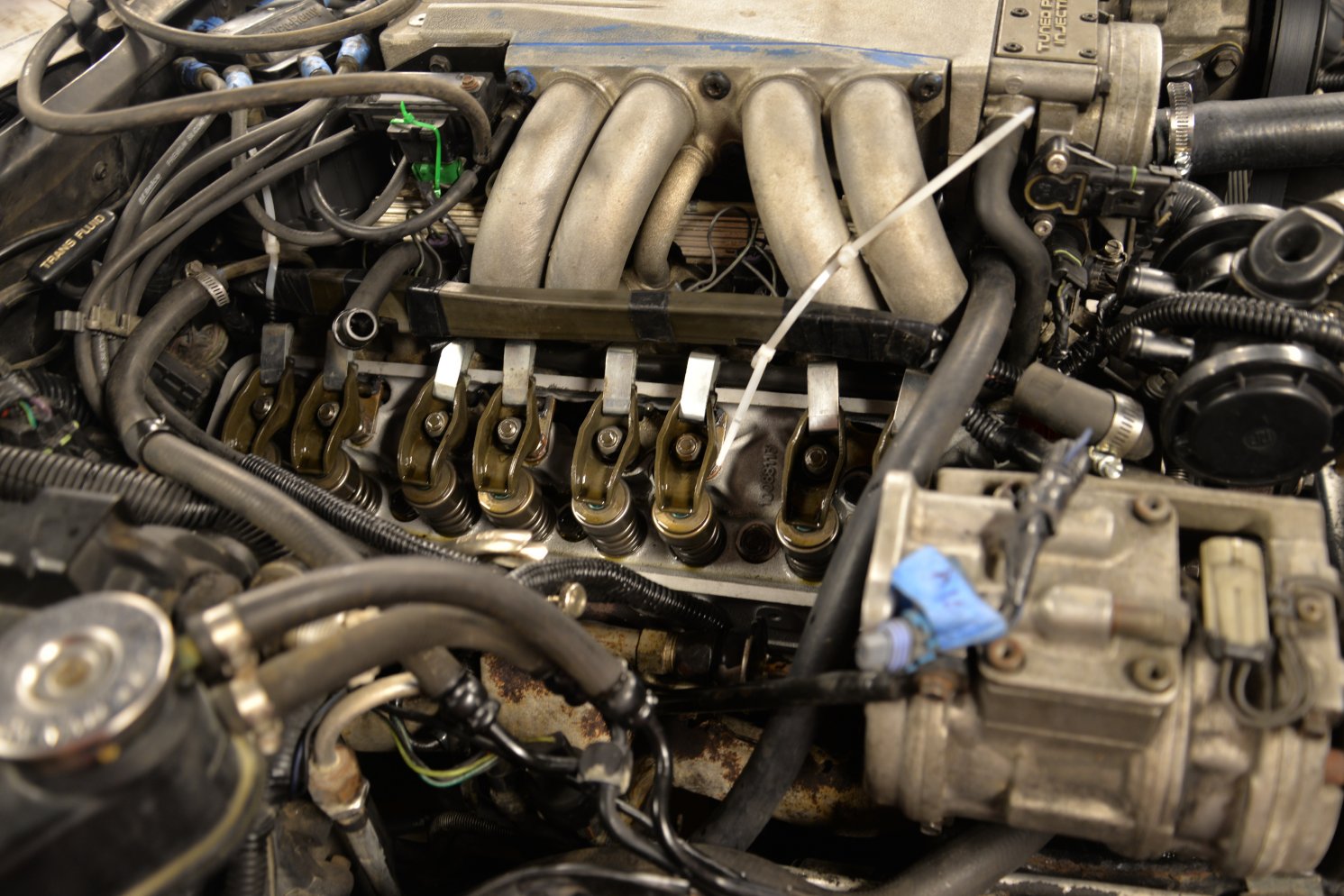

Hi woodstockdrift. I was just able to read your post. To answer your question(s), I'd put some more M.M.O. in it and run it till the next oil change. You have nothing to loose and it won't hurt anything. Here's my reasoning: 1.) Your ticking ISN'T real bad. Heck, many, many engines tick a little at idle because oil pressure is low at idle with most stock oil pumps. I've heard some that sound like a "popcorn machine." You said the noise goes away after 1500 RPM. That's just a little touch of the throttle. So don't get all wierded out over this. It's minor.
2.) If you REALLY have to address it NOW, I'd pull the covers and inspect it. Grab each rocker and see if any are loose and can be moved by hand or try to twist the pushrod. Pay particular attention to the ones in the area where you defined the noise. If you find a loose one,..Viola!
3.) Wether you or your mechanic adjusts the valves, I'd BE SURE to use a set of "Rocker-Stoppers," on the rockers arms while adjusting, to prevent HOT oil from being thrown all over the place. Lisle Tool Co. makes a set #35500 that is on Amazon for like $11.50 Amazon.com: Lisle 35500 Rocker Stopper: Automotive Great little invention those Rocker-stoppers!
4.) If you think you want to try it, I could explain how to do it, correctly. You'll need a vacuum gauge too. It isn't hard. JUST a bit MESSY! but if not, I understand. Here's a picture of mine with the rocker-stoppers on it, before I started the adjustment procedure.
Note: My stoppers are antiques. The new type are a bit different, but you'll get the idea.
Keep me posted and let me know how you make out. Don
