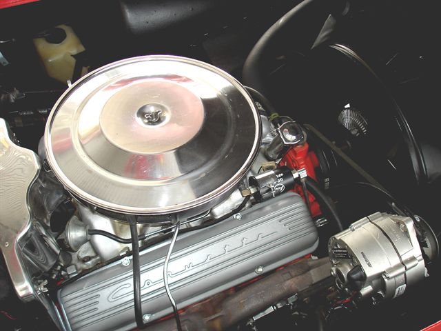

100_2866.jpg Here is a photo of a 461. Will continue to look for the T-stat housing if I have one (haven't found it yet and have been looking through boxes). I don't know what year the 461 was first installed on, it was used on the L79 350HP and the L76 365HP engines in 1965.
Mark.

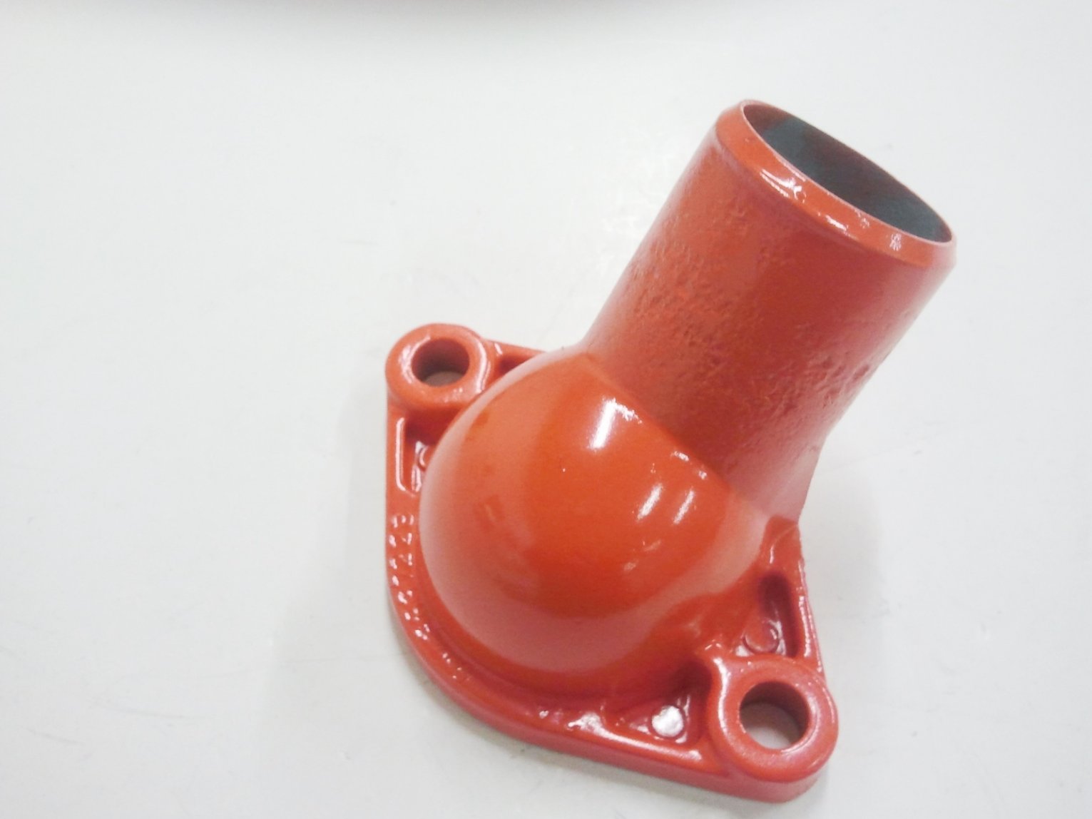

461 T stat housing I believe is correct
Cast Aluminum Thermostat Housing Part No 3837223

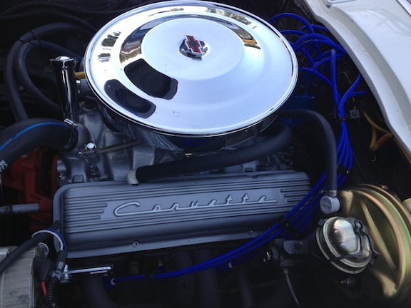

I have several photos of engine compartment configurations (so I can put everything in it's place) 1965 365 HP engine.jpg This is using the 461 manifold and the ignition secondary wire shielding. The vacuum advance diaphragm fitting points to the alternator. You can see a depression in the runner for #8 that the vacuum canister is very close to. The coil is is to the rear passenger side of the canister. My apology to the Owner of this engine. I am using this photograph for illustrative example only.
Mark.
Thanks Mark
I have found a few of these pix's.... but this one is a goodie

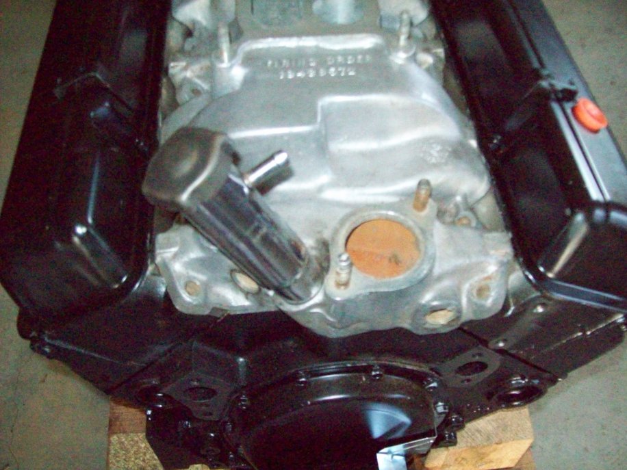

So after going thru all the fun with the rocker covers and all. It dawned on me what frickin heads are in this.. and since the rockers covers were ready to POP I took em OFF... A little wipe down and ..... AND
Play music--->>>( Fantasia in G minor, J.S.Bach BWV 542/1 - YouTube )
HENCHO DE MEXICO OH GOD NO!!!
3998993
307/350
68-79
1.71/1.50 OR 1.94/1.50
76cc
I found that (Hecho en Mexico) on my 350/290 H04 crate engine from GMPP. It will make a driver, I don't think that it will cause any problems until I sell the car. If I sell the car. Engine casting #.jpg
Mark.
