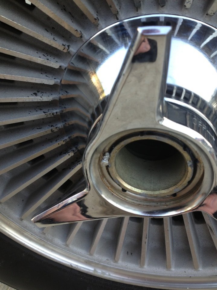

Broken pin drilled out ( seems like .a .156 pin X 1.25 ) , wheel off cleaned center hub & cap of WAY to much RTV that didn't bond.
New RTV applied & curing ( 24 hrs ), will mount the wheel back on in ~ 8 hrs...

Original KO's had no pin and if installed properly NEVER come loose. The fact that your pin fell half way out indicates that the spinners are probably not tightened sufficiently. Don't rely on a stronger pin to keep the wheels on the car.
Mikey
The pin didn't " fall out " it was mashed back in ( mushroomed ) enough so it wouldn't go back in all the way...
That spinner was ON and took high strike force to just budge it... The PIN to me is just saftey ( read paranoia )

The BEFORE
Beat down

If the wheel is installed/oriented correctly (drive pins on the adapter in the five small holes and lug nuts in the five larger clearance holes) and a film of anti-seize is used both on the spinner and adapter threads and on the angled mating surfaces on the spinner and the wheel, the wheel isn't going to go anywhere. The film of anti-seize is important, to minimize thread friction that will require much higher torque (hammer blows) on the spinner to create the required clamping force in the joint between the spinner and the wheel. The KO hammer that came with the car originally is a one-time-use roadside emergency tool; what you want is a 5# or 6# "Mother-Thumper" lead hammer. Six or seven whacks with that (with the tire on the ground), and you're good. :thumb
John you read my mind
the first thing I did when I got the goodies was to sort out the adaptors & spinners for D/S P/S and mark em....
THEN cleaned the threads with WD-40, wiped them down, used the air hose and did the anti seize......
My one time hammer is hammered.. and I did buy a new #5... which is getting a workout....

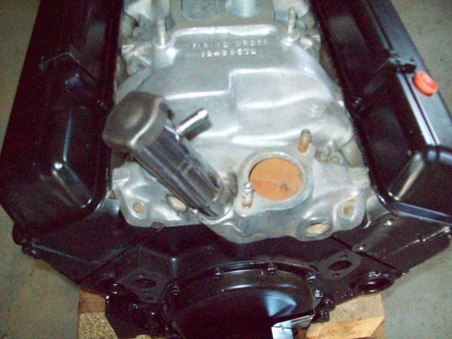

Yeah BUT.... Jackfits manifold is painted
I like this look~ ( minus some of the staining ) .....
I'm having mine painted....

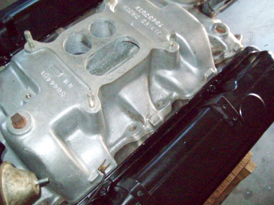

100_2865.jpg This is my 461 in bare aluminum, I have only used Simple Green and water with a old tooth brush to get the 47 years of loose dirt off. I was going to use Goof Off to see if the staining comes up. Some of the
Permatex used to seal the water jacket is still on the front of the manifold. Inside looks like the outside.100_2866.jpg Except where the coolant was allowed to transfer rust to the inside.
