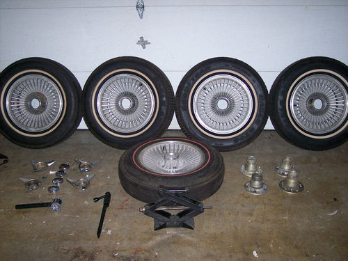

COOL... so the spinners & hubs arrived.. wheels are on the way...
I'm doing my research BEFORE I even think about mounting these bad boys on....
There is so much bad press on these probably due to bad installs.. I want to make 398.625% sure I don't do it WRONG!
So I found this
http://www.lbfun.com/warehouse/tech_info/Wheels & Tires/KOwheel.pdf
And I have my trusty shop manual...
I spent some time polishing up the chrome on the spinners and found thread direction
BUT I didn't find LH or RH on the hub adaptors , but I didn't look that hard, yet.
I'm missing the lock pins.. so I'll have to order that..Some have suggested cold roll pins... thought's, dimensions ?
Is there anything " magical " about the lug nuts? I see there are the ones for the steel wheels & ones for the KO's that seem a tad longer?!?
Please chime in....

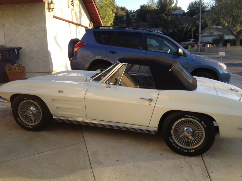

In other news, Mutley went for a ride, got a bath and as an extra treat a top down ride home.....
SWEET!

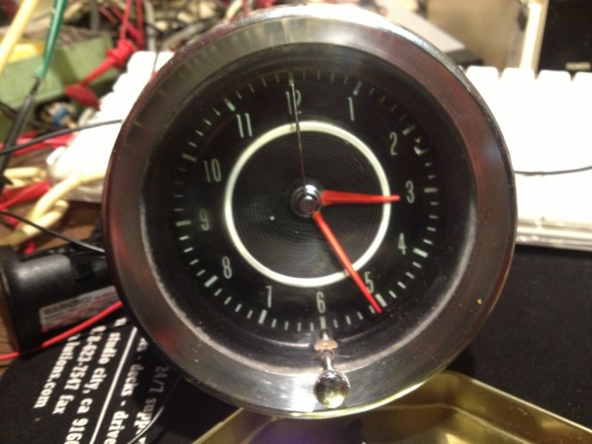

Tic Tock
My first clock rebuild.......
Before N after

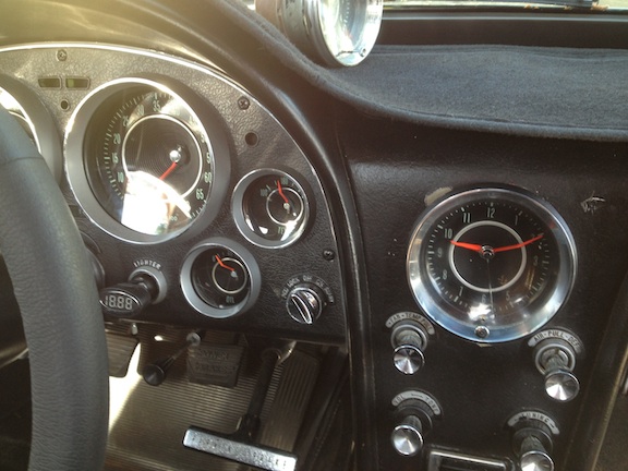

And IN
Tada

Very nice work on the clock!

Preview of coming attractions
ohhhh yeah

Bling baby
Oh yeah.... always wanted KO's
