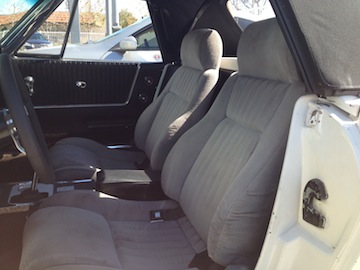

Fireo seat upgrade.. Oh SNAP something went right....
So the shop called today and stated they wanted my butt down there to verify fit of the seats....
The also stated that the 88 Fiero seats picked up all the existing bolt holes... NO sub bracket needed..
WTF... something went according to plan... something is amiss!
Mike
Goalllllllll
4 small brackets fabbed to the new Fiero seat tracks ( per seat ) and it's GOLD.....
So still able to use stock OR fiero.....
1 minor problem.... now that these seats have padding I might have to get a tilt tele coulmn or go on a diet ! LOL

So to get the rear end profile the way I wanted it I had the shop remove 2 of the leafs on the new spring AND use the LONG bolts....
Now the car sits low & mean ( doing final tweeks on alignment ) .... Plus the ride is much nicer..
Before every time I hit a speed bump my spine would dislodge.. and it doesn't look so agriculture anymore!
I like the new fiero seats... ( need to pull a bit of padding out when they are re done ).
( the grey velour just isn't working for me )

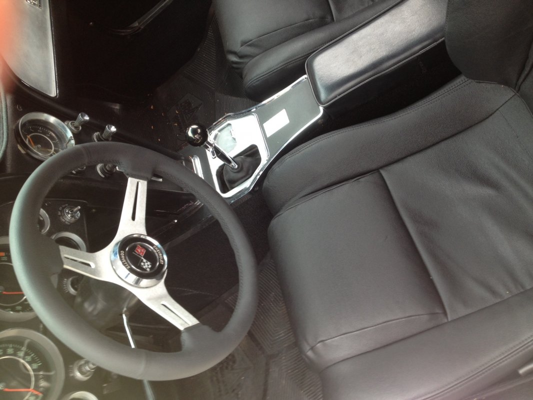

HAZA I'm BACK and the easter bunny strikes
So new caps & trim rings, new seats ( yes I had to not put in all the padding) , new carpet. reset the timing & vac advance PROPERLY and it's a whole new ride....AND installed the reverse lights B/U relay so that's all done...Plus ordered some super bright even field LED's for the taillights & new lighting gaskets.
BUT the carb has a problem, the bushing in the throttle plate has worn out and I cannot get below 900 for idle... oh well...
Had another nagging problem, since the install of the Vac booster, 1 out of 10 times the brake light would hang ON.. well a Spectra CHROME carb spring took care of that issue going from the back of the pedal
to the Steering wheel support bracket.. for a little extra help...
PLUS scored a set of 4 western aluminum knockoff's CHEAP & CLEAN.. arriving next week...
Still on the hunt for a more " correct " manifold ( and now carb ).
Plus the tighten down the intake manifold trick solved SOME of my oil burning issues.....
AND
I scored a 64 clock complete, cleaned & oiled the movement, burnished the contacts and it's working ( kinda ) ... it keeps time ( minutes & seconds ) but most of the plastic gears are done...
So this get's sent out to Rodgers gauges next week.
HAPPY EASTER
