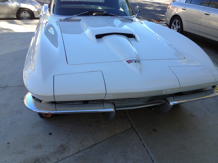

As you know Mutley has been teething for a while
TADA....FRONT TEETH!
( first time since 1966... best guess )
Mike

sure does look nice!!!!!!!!!
Andy :w
Quite a nice looking smile, indeed!
-Mac
