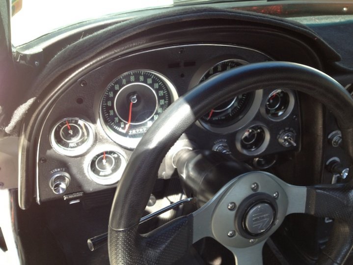

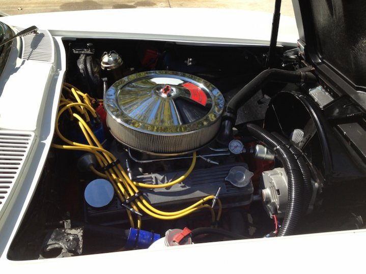

Cleaned that all up.
Soaked the valve assy in hot soapy water for 1/2 hr... that got all the Yeech outta there..
Put it all back together... nuttin.. gave up for today on that.
Did an inspection on the petronics.. and the reluctor was hanging down a HAIR to far, not allowing the advance weights to move freely.
( straightened that all out ) car still starts...
And then noticed the feed line from the washer bottle came off...
I need to replace the line, so I hope that is the " issue "...
Had to move on to house chores....
Mike
