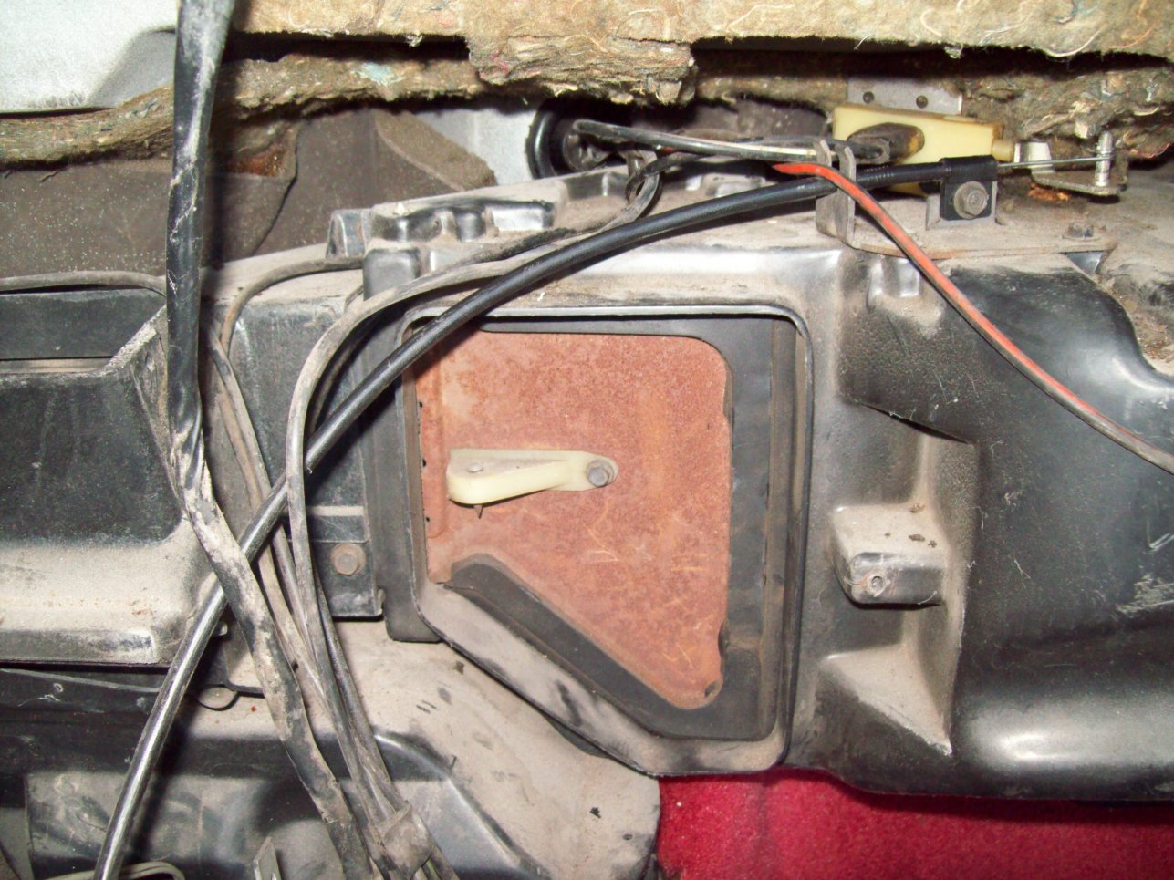

Thanks in advance for the interest...
I printed this diagram a while back and I still don't know which one it is? The one flap that opens and closes at the bottom of the picture is for the Defrost flap, it has a blue hose connected to it.
Does anyone know if it is controlled by a vacuum or by a cable? If vacuum, then where is the cannister? under the hood?
Thanks for the help!
Kiki

My 81 is a vacuum operated system... I think most of the generation are.mine has a selonoid on the rt side of the engine, but the engine needs to be running to create the vacuum.
Should have a vacuum diaphragm. It looks like it should be mounted behind to the left (if that makes sense to you)
i believe that vacuum line with the orange stripe should probably be connected to it.
It's a 1982....I discovered that my vacuum is not pulling hard enough from the Cannister. I'm going to start a new thread on it....Thanks for responding!
Also it should only be open when ac is set to normal max or vent.
may be a tan vac line not orange
