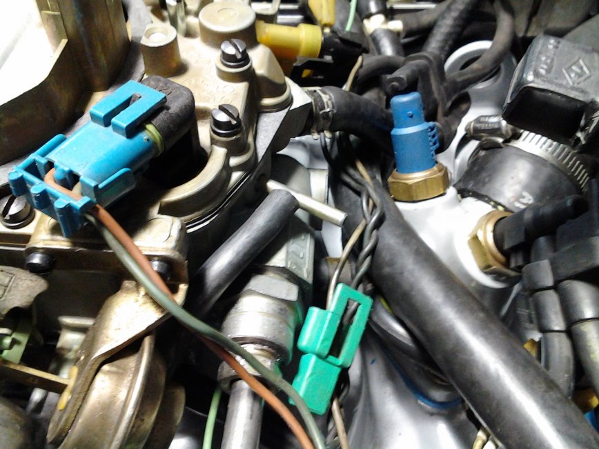

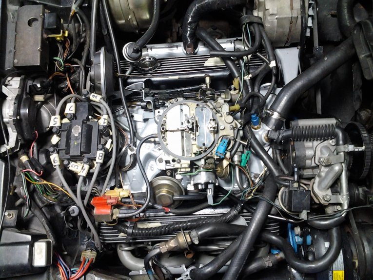

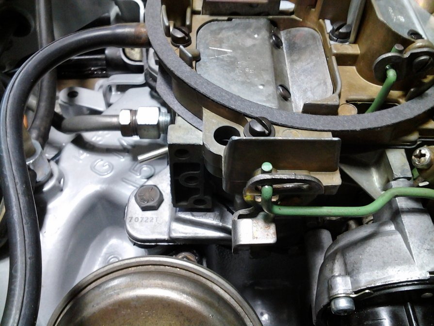

these two ports on my carb. one in front and one in back. what do they connect to?

The one on the back is connected to a plastic tube that goes to your MAP sensor (on the firewall behind the TCC bleed relay. :)
The one in front I don't know for sure. Or it's connected to your EGR valve or it is connected to your air intake snorkel for the flaps in the snorkels.
Greetings Peter
thanks. i read an older post of yours and found the locations on my under hood sticker. now if i had gas and a battery id be ready for a start up. may be this weekend ill get it running. then ill fix my leaky power steering and whatever else jumps out at me.
Your engine compartment is looking nice.

The front one is definitely from the snorkels on the air cleaner.
