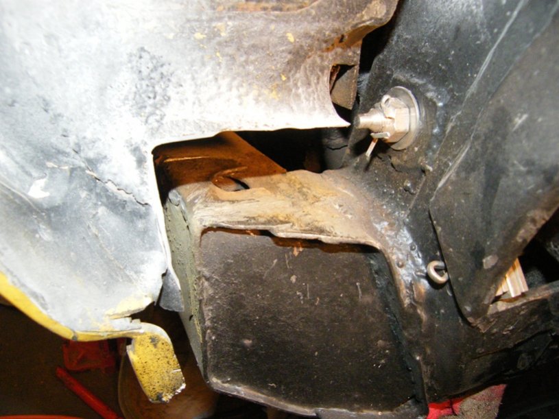

The body mount bolts all came out like clock work except for this one. I thought I let the WD40 soak long enough.
DSCF7659.jpg,DSCF7661.jpg,
That was rough, think i'll sit right here.......:hb........and drink a Beer.

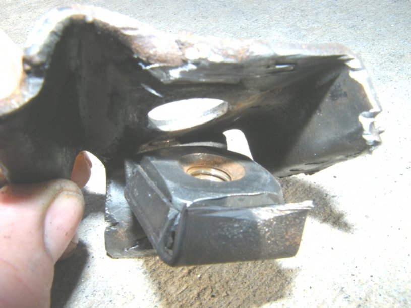

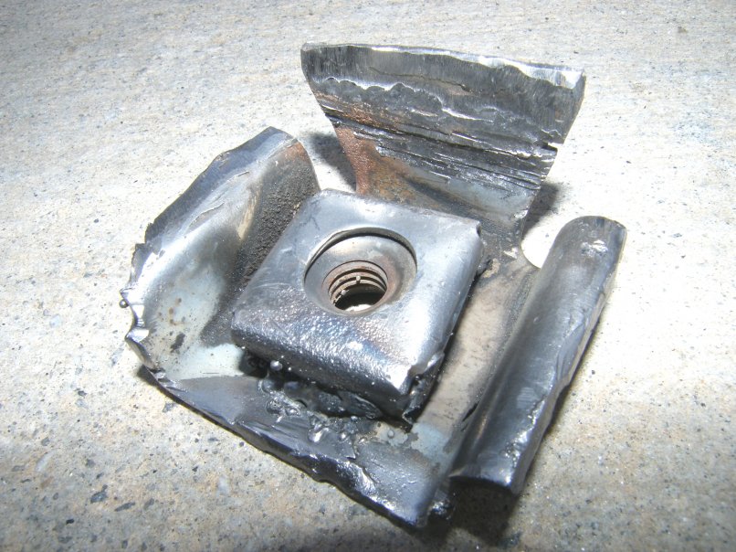

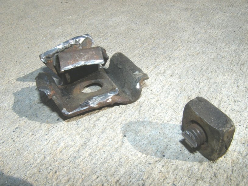

Another problem to be fixed
Number 1 body mount on the drivers side was rusting out. I cleaned all the rust out and welded a shim to the top, then drilled out the hole to fit the bushing. When I install the shims on thi one I think i'll leave one out.
