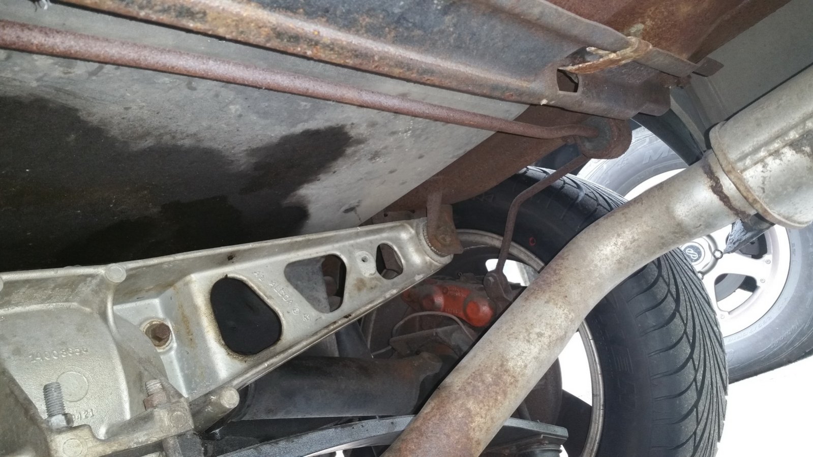

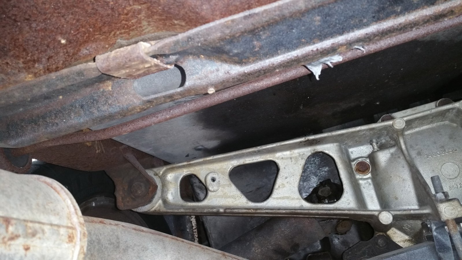

Are the attached images the bushings?

The OP says the car is a '79 but the images you posted clearly show the drive axle for a 1980-82.
you're right i just discovered... title says 1979 though.... must be late model when things were changing over...
The side bushes are there. I was more thing of the front bush. Have a look at the front of the diff above the drive shaft.
I was forced to bring it somewhere with a lift.... guy says 2 side bushings are bad and the front diff bushing... and he says the frame is bent.... and the diff pinion seal is leaking.... as well as body mounds bad of.... all this crap causing the left shaft to slightly rub against the battery box he says.... I wonder if I should have the bushings done? He said it might fix the issue but didn't give me a price... said he wouldn't know until he started it.... What do you thing would be an accurate price for doing the three bushings and pinion leak? Thanks for your help

No '79 Corvette left the factory with an '80 and up 'batwing' style diff. Somebody possibly modified the car to adapt one and done it poorly which is the root cause of your present problems. Impossible to know how much it will cost to fix.
