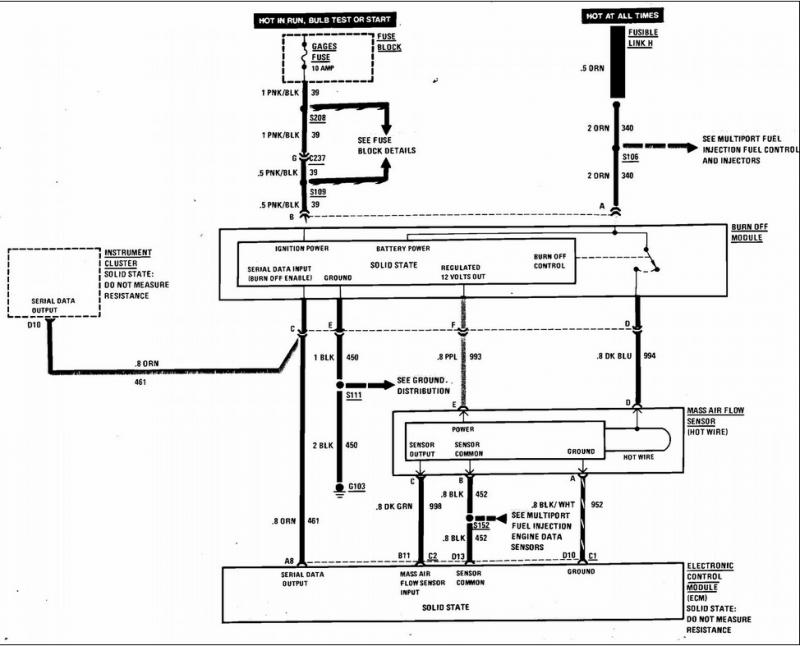

mafwiringdiagram.jpg here is the wireing diagram for the MAF burn off for an 85. Hope this helps

unfortunately on an 85 its on the inside of the car , it is its own module it wasn't part of the ECM on an 85 thanks for trying : )
