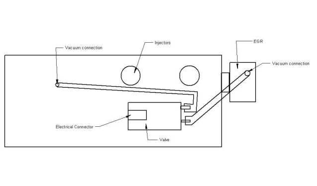

Does anyone know if there should be a vacuum line on the back side of the valve that is mounted on a one of the bolts for the thermostat housing? The valve has two lines on one side that go to the EGR and I believe the under side of the TB but on the other side of the valve it has a clamp to hold a hose on and there is a hole in it as well.
Thats is NOT a hose fitting....it just looks like one. That is actually the vent for the valve. When vac moves the valve inside the air has to exit for the tiny amount of vac to be able to work. The vac lines go either side of the solenoid on the longer fittings. Which goes to the T-body and which to the EGR valve....I cannot tell you or know if it makes a difference.
