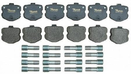

ACDELCO Part # 1710959 {GM #19153019} PAD KIT,FRT DISC BRK 2 DOORS; w/HVY DUTY ANTILOCK BRAKES(J56) $292
RAYBESTOS Part # ATD1185M Advanced Technology Front; Semi-Metallic; Z06; Originally Equipped With Semi-Metallic; Contains Hardware $201
You be the judge......
