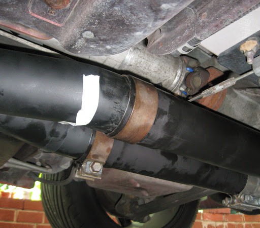

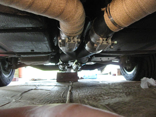

I just put OBX's + open 3" + PE exhaust on my '90 Z, and it's just a little too loud - DRONE-wise. It IS running SUBSTANTIALLY cooler now than with stock exhaust - NO DOUBT about that!!!
See headers install snappic thread HERE FROM A-Z...
I'm gonna' first extend the header wrap to the rear diff split, after I get a decibel reading AS IS. THen decibel measure again with wrap extended.
Then I'll probably try to find 2 x single resonators, or hack / fab the OEM resonator to have 2 x 3" inlets + outlets, and re-try.
What hardware DO you have???
Wrap is only to the X-Pipe ATM...
