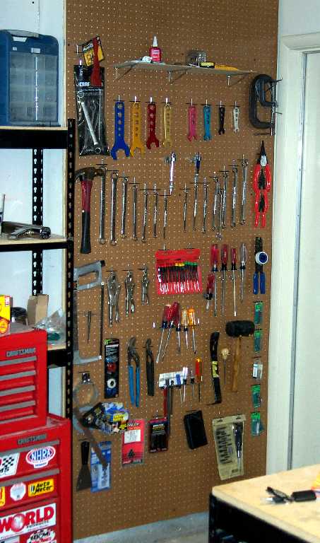

Here's some, but not all, of the stuff you'll want, if not exactly need:

Wow, Mako, that's some setup you've got! That's what I was thinking. For someone like me, it would be hard to start off in auto mechanics because I would be starting with zero tools. Of course with time and needed jobs, I would acquire a set like Mako's, but you need to start somewhere! :D

That wall ain't nothing compared to what most mechanics have... LoL

Amen to that! I have all my ratchets and other stuff on peg board behind my work bench, and some specialty tools like torque wrenches &ct in drawers etc.... Even then, I don't have half the tools a pro does.
I've yet to hear a mechanic complain about having too many tools ;-)
