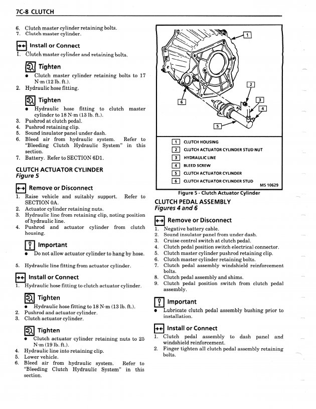

I would guess the clutch dead man switch has slipped out of adjustment. The plastic tabs that hold the switch in place become brittle and break. So when you push the clutch the switch moves backward in the bracket and the plunger does not complete the circuit for starting. You might take the wire connector off the switch and jump the connector with a paper clip. Be sure to set the emergency brake and double check that the trans is in neutral. If the car starts you have isolated the problem. I know from experience when those switches no longer stay put you can not make them it is time for a new switch.
