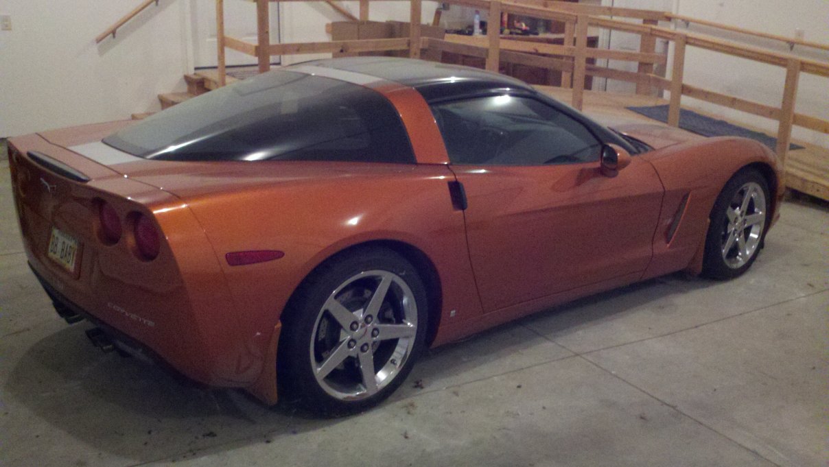

These are the flaps I want to put on my C5. I think these are the Altec 2012-11-25_23-47-23_431.jpg
These are the flaps I want to put on my C5. I think these are the AltecView attachment 11927
Yes, those are the Altec. Do yourself a favor and just to be sure; Go to RPIdesigns.com and in their search box, type in splash guards. Scroll down to C5's splash guards and you will be able to compare the ones you like to really cheap ones to the more expensive ones. The last ones are the modified C6 guards to fit the C5. Note the cost differential for their labor which is certainly deserved, but could be a DITY.
