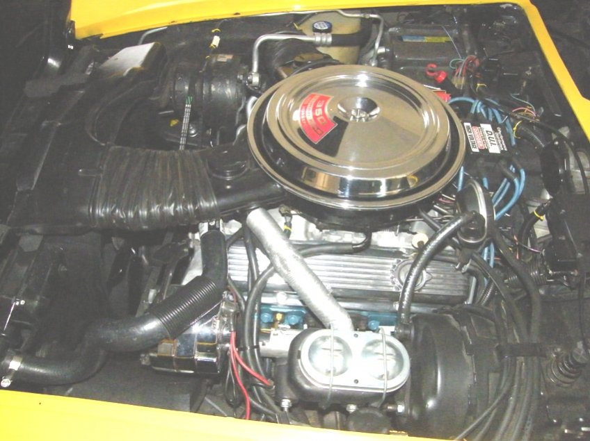

I rebuilt and set my E4ME carb up per Michael Levesque's and Lar's Grimsrud's modification's specs. I'm using the stock manifold. I installed a Hypertec chip in the ECM and DUI distibutor. I installed 2.50" duals with a bowtie crossmember. Don't know how much horsepower I gained, but it will smoke the tires really good from a dead stop. Pretty good for a almost stock L48/81. Quadrajet Modifications
http://www.crankshaftcoalition.com/wiki/How_to_Rebuild_a_Rochester_Quadrajet_4MV_Carburetor
How to Rebuild and Modify Rochester Quadrajet Carburetors by Cliff Ruggles Book
