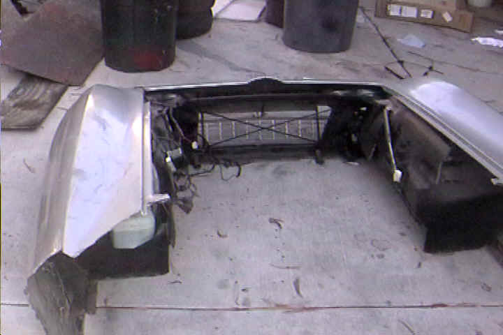

Love the look of the hard top!.
So... Long term plans for the front end?
Original Metal?
(this is a '67 front end never wrecked with headlight assemblies and motors, grill all clips, brackets, harness, core spt etc. -$6,900 )
Fiberglass?
Great Pix Mike. She really does look a lot better in the Calif. sun.
Keep them coming as the work progresses and have fun!
Great shots! Feels good to check each item off as you work your way through your list, doesn't it?
I'd add one more thing to your "reliable driver" list - that would be to get an all-metal fuel system between the tank and the carb; would hate to see all your work go up in a "car-b-cue" 'cuz some piece of rubber/plastic/glass let go.
Keep at it, and thanx for the pics! :beer
Wanna hear something scarey? That front end is starting to grow on me. :eek Doesn't look half bad in this picture. I'm with John, please fix the fuel line next. Remember what happened to Rick's blue '69.
