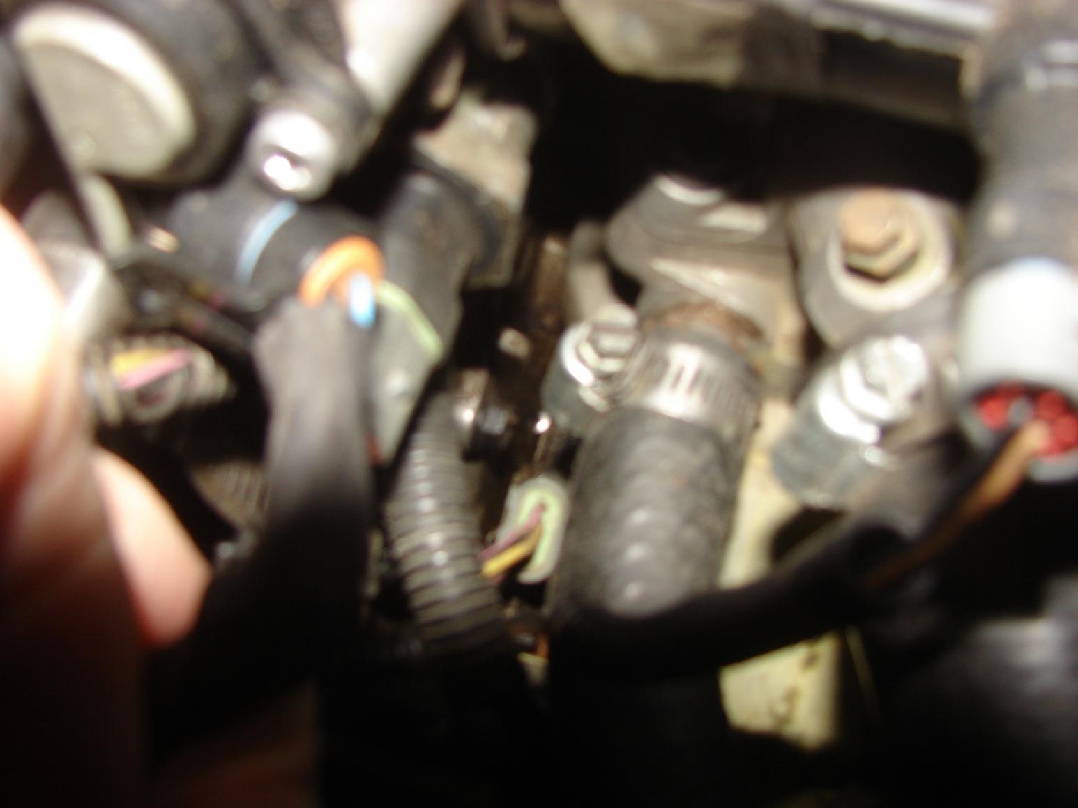

Blew a hose actualy had a spare in the car replaced it and drove on. 4 days later car developes a hard to start condition some times will start and run however when at idle not all cylinders with RPM increased seems ok. and drove fine now wont start have opened all connectors and blew with air but no improvement. code 100,300 and as always i have a 0441.

Did you clean the connector on top of the opti

Cleaned and blew them all out no improvement...
Today i decided to replace the distributor cap as one of the contacts (coil) isdamaged from past work.
