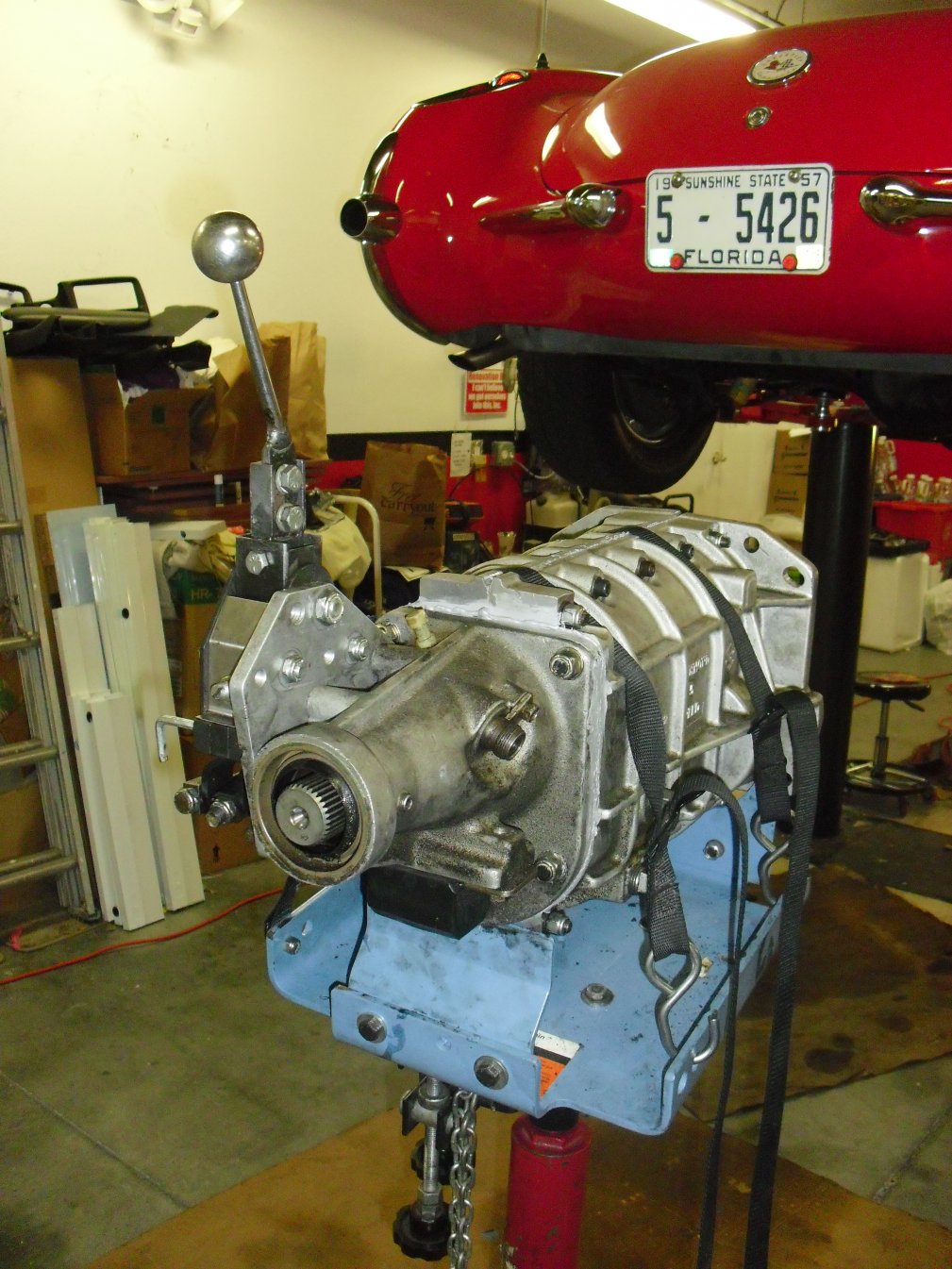

I put a Richmond Street 5-spd in my 57 in 2002. Only 2 modifications: 1) had to get a fine-spline yoke for the driveshaft (still using the stock driveshaft) & had to fabricate a new trans mount. No other body/chassis modifications at all! Pics are on another computer so I'll try to post 'em shortly. Driven to CA from FL; MI from FL, NCM from FL (& back, of course) all without problem one. Ask around...my 57 does not go on a trailer.
Here's a few pics: The trans mount (bottom of car is to the right...); next 4: out for a little repair in 2013; the last is the installation with a correct 57 shift lever & custom 5-spd plate.
The 2nd to last pic showing the trans out- there's no mods at all with this unit. It bolts right up to the bellhousing.
