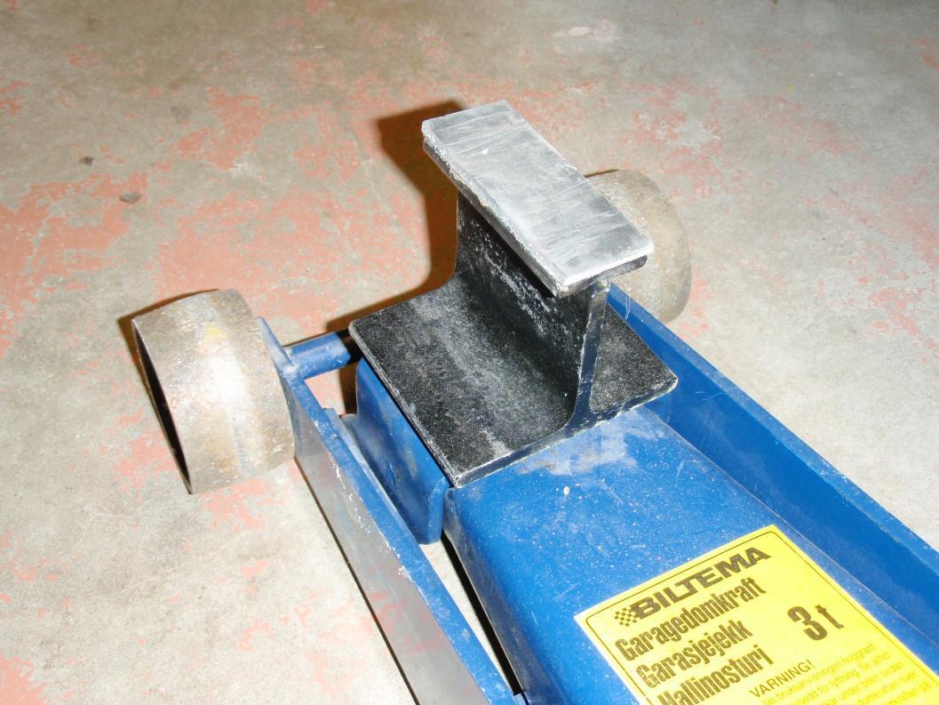

2. In the rear I'm using this, The Corvette GadgetMan: All

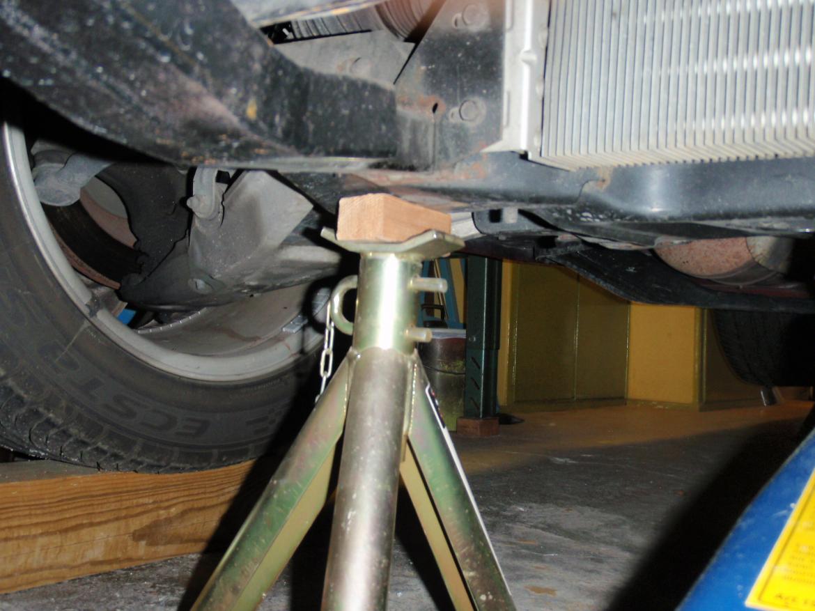

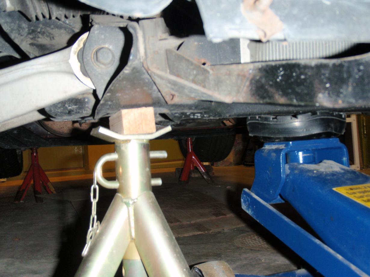

I jack the car up to full height using my jackstands with wooden pieces, I found a good place to put the jackstands on, right in front of the rear wheels, where different parts of the frame are welded together. Just be a little careful on the right side where the fuel lines are close.
3. Now when the rear is raised, I move to the front, and with the wooden blocks used in step 1, I can now put my floor jack in from the front of the car under the front crossmember, and lift he front up to full height, putting the jackstand with wooden pieces under the skid bars, just next to the front crossmember.

The floor jacking procedure in the above article differs from what I posted previously bit either way of lifting the car with a floor jack would work.
The positioning of the jack stands discussed in the article is about the same as what I described in my post to this thread. Seeing it in pictures is always better than just text.
I suggest that the OP take a look at that article.
Lastly, the "C4 EX-Jack-Adapter Device" discussed by web page at http://www.corvettegadgetman.com/products3.html is a product similar to the discontinued "Jack-a-Vette" tool I have in my shop. Someone looking for a tool with which they can lift the rear of a C4 should consider it.
Of course, one picture says more than 1000 words. I just did not have any pictures available when posting to this tread.

As promised, pictures added, in cronological order.
1. In the front, I first use my floor jack under the front crossmember, diagonally from behind the wheel to lift the car up and place the front wheels on special wooden blocks.
3. Now when the rear is raised, I move to the front, and with the wooden blocks used in step 1, I can now put my floor jack in from the front of the car under the front crossmember, and lift he front up to full height, putting the jackstand with wooden pieces where the skid bars are connected to the front crossmember.
