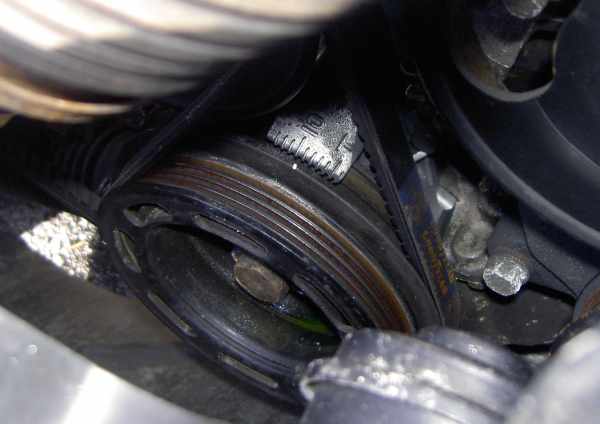

If the ring with the mark for timing has slipped on the pulley balancer, the test I described is useless for static timing.
If that's happened, I don't know how you zero TDC???

You find TDC physically by making sure the #1 cyl is at TDC by using a pencil or something to actually feel when the top of the piston is at the top of the stroke and then remark the flywheel by scratching it or otherwise making a new timing mark for TDC.
How many degrees within '0' can you get that way?
Is the crankshaft notch for the pulley key at '0'?
edit:
apparently the notch is not at '0' link
I found a post too by vetteoz in 3gen.org saying timing mark is not on the crankshaft notch.

Close enough to determine if the balancer outer ring has slipped.
If the balancer is original and has not slipped, yes the notch is at 0 deg. Balancers vary though...if it needs replacing it MUST be checked against #1 TDC.
