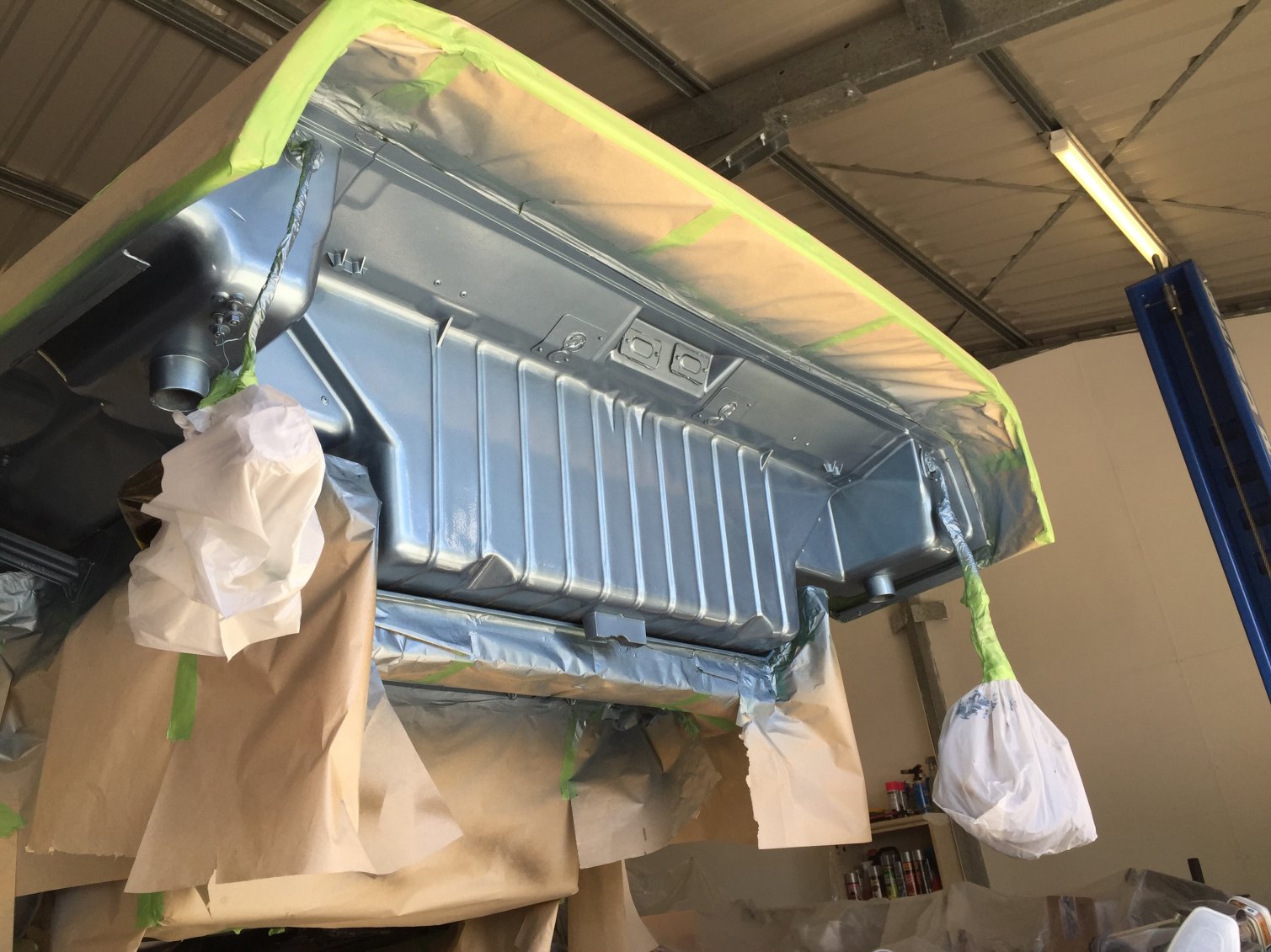

I am starting this conversion.

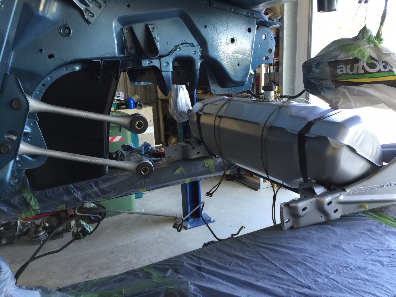

I have started at the rear of the car first, I had to replace my fuel tank as mine was very rusty on the outside, due to the overflow nipple not being connected to the overflow hose I think.
I was lucky to have been able to secure a parts 84 Coupe which had a better tank, but no fuel sender.

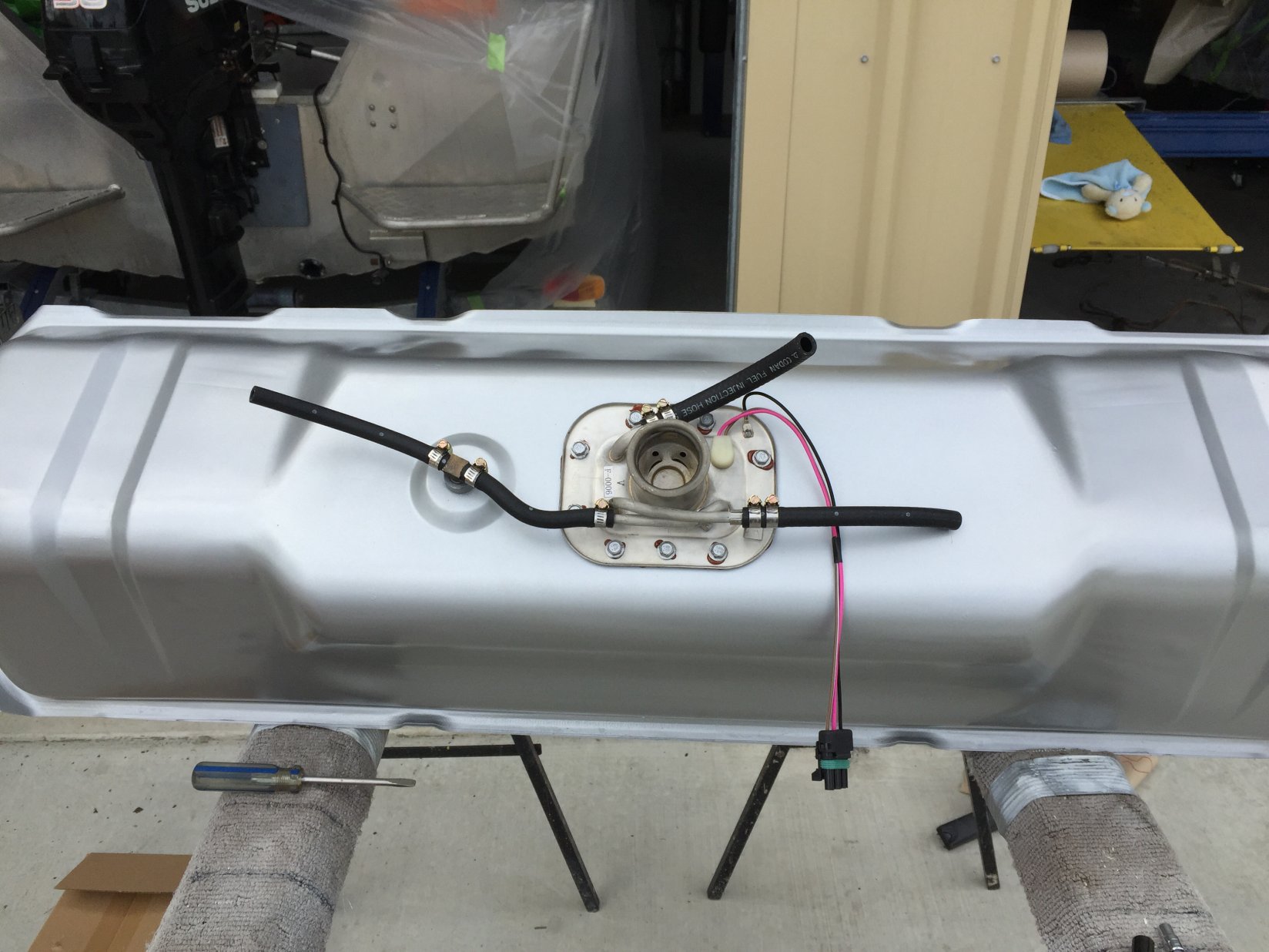

My 84 sender was sticking anyway, so I decided to grab a GM Restoration unit for 85 to 87 Vettes.
I now have installed the new 85 to 87 pump and sender in the used, cleaned and repainted 84 tank.
I am yet to install all this in the aluminium frame, I just have to finish cleaning the tank frame, priming it and then paint it. The paint on the tank and the frame is aluminium high temp, not that I need high temp paint, but when this is added to high temp clear coat, it looks really good and is resistant to chemicals.

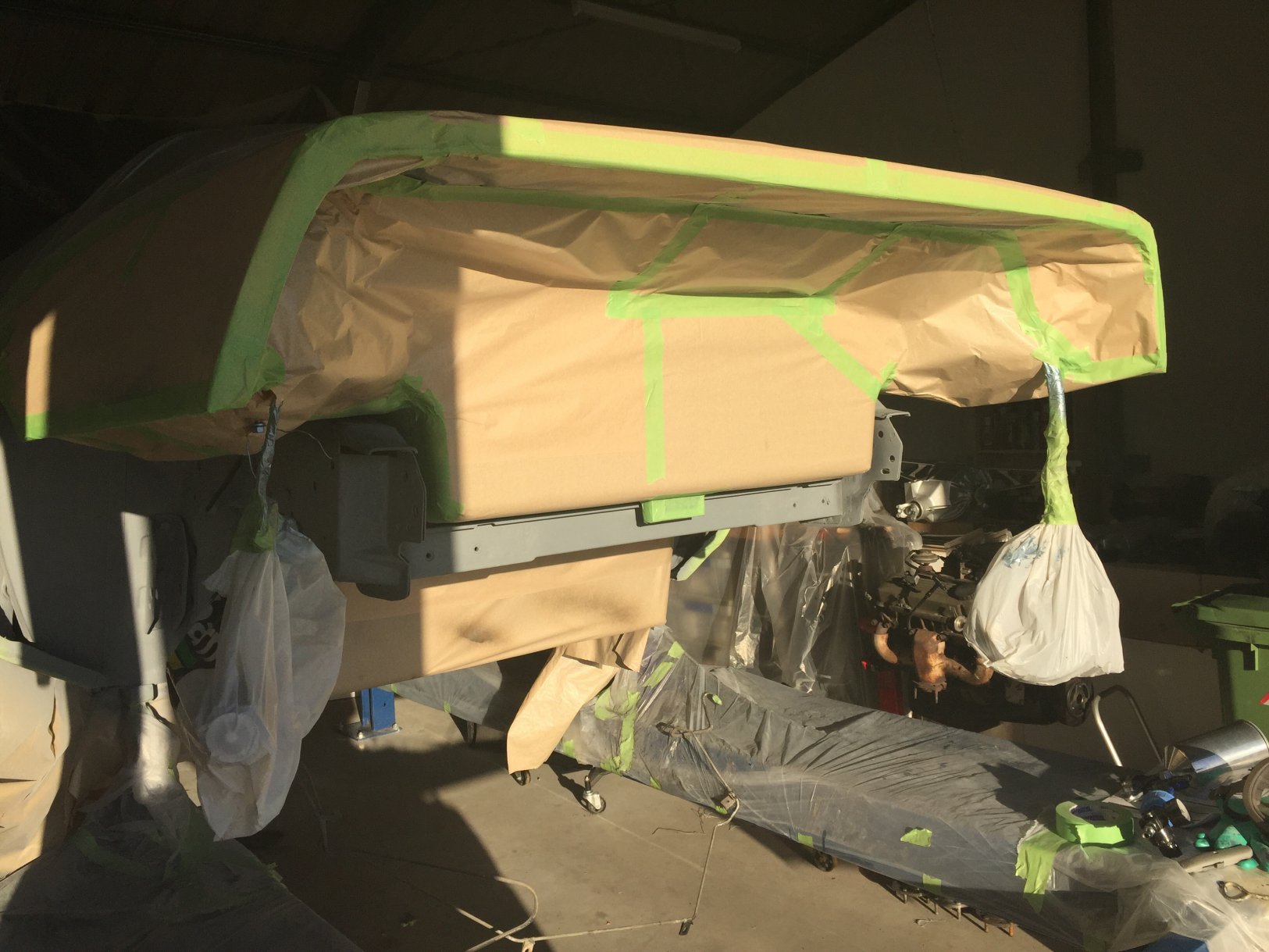

I am also in the middle of repainting the underside of the car, as mine is a two-tone blue car, I have cleaned the underside and cleaned the chassis rails and have painted the light blue and am ready to do the dark blue.
All the dog bones and strut rods have been cleaned and painted and have new bushings, new spring mount bushings, new tie rod assembly, differential rebuilt, new differential mount bushings, new Callipers (painted with new brake hoses), new wheel bearings, seals etc...new rear driveline, suspension and brakes.
I have two sets of fuel lines from my 84 and the parts 84, that I can retro fit to take the 85 fuel filter and after I pick up some new fuel line, I will bend up fuel lines to meet up with the TPI.

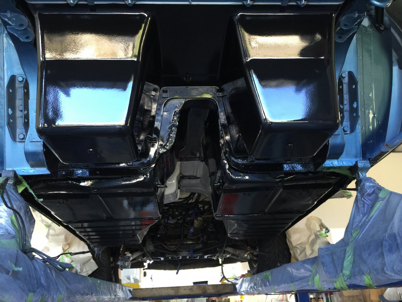

I have finished repainting the floor and have sprayed the inner wheel wells with the two tone blue combo like the Vette. It makes the suspension components stand out and will finish off the job.
I sprayed the fuel tank and fuel tank frame, came out like powder coat...very impressed.
I sprayed two-pack paint blue and matt black, and even though some would be concerned over safety around two-pack paints, my shed was well ventilated and I was wearing a spray suit and double filtered mask...if I was doing the body panels, it would have been in the booth for dust mainly.
